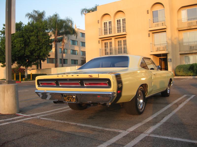

FFLosAngeles2013 074.jpg This is the result of a single Summit truck spring that was trimmed to fit and inserted. Got about an inch. 2 inches is a lot. I too love these threads!
