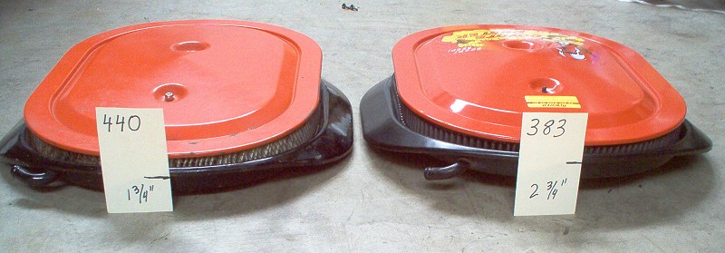

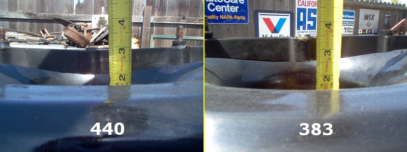

The stock 440 (RB engine) is 3/4" taller than a stock 383 (B engine), therefore the factory used an air cleaner base on the 440 that was cut down 3/4" shorter than the 383 air cleaner base. This resulted in the same overall underhood height of the two engines when used with the Ramcharger hood. There are a number of popular aftermarket intakes that can be used to increase intake flow on your new engine build. However, not many will fit and still allow you to use your Ramcharger hood. You will HAVE to use the air cleaner base from a 440, not the original from your 383. But that will just get you back to EVEN on the height if you use a 440 (RB) engine. It will not give you any additional margin for your intake manifold on an RB engine.

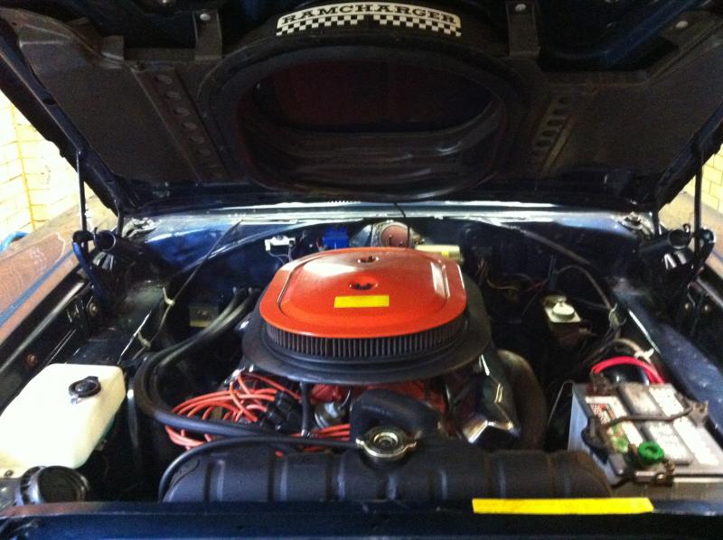

As previously suggested, you could stroke a 383 (B engine), or better yet get a 400 block (B engine) and stroke it. I've done both (383 to 426 with 440 crank)(400 to 499) and the 400/499 is also going in my 69 Super Bee with Ramcharger hood just like yours, so I've been where you are heading. I will include a photo of the 499 with the Ramcharger and also a table I set up with measurements of some various intake manifolds that I was considering using. Maybe it will help you decide what you want to do. Good luck!

As for the 440 base air cleaner, they are being reproduced now. I got one from BE&A. Not perfect, but not bad either.
