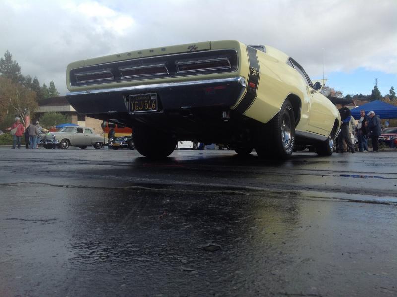

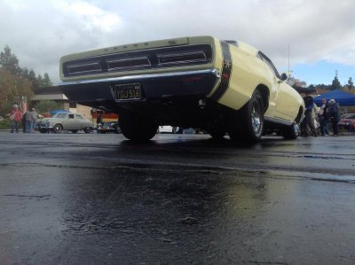

I always thought the SS springs were for equally loading the rear axel on the launch. Right side being stiffer and a bit taller. You can see it in the cars stance from the rear. Factory ordered race cars would even have them as an option. The rear on my '62 is needing some help but I'll be ordering same spring profile for both sides.

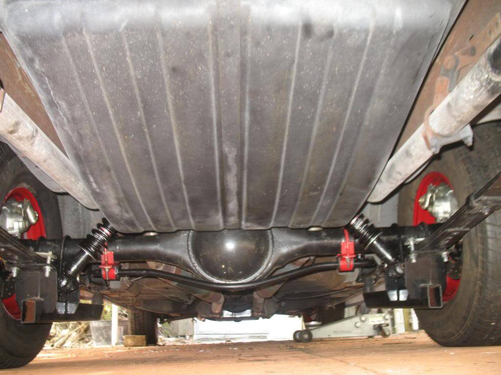

I agree to a point depending on how much you are lifting a car. When I changed mine to raise the car about 1/2" you cant even tell its a bit longer then a stock shackle and one reason is I hate to see 6" of shackle hanging under the spring as I cut the extra off. But you can see in the pic these are not much longer then stock but it raised my car a good 1/2" and they will be fine with no problems at all as they have been like this about 5 years now. The shackle itself is only about 3/4" longer then the stock ones. But I would not use shackles to raise a car 2 or more inches as that would make one long flimsy shackle. Ron
