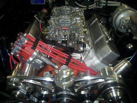

i had same problem with the standard msd dizzy, then i found they make an extended shaft one so i bought that and it fits good.
not sure if petronix do same, some guys have used offset distributors, or maybe you could grind soem out of the head?
heres mine with the longer shaft dizzy
