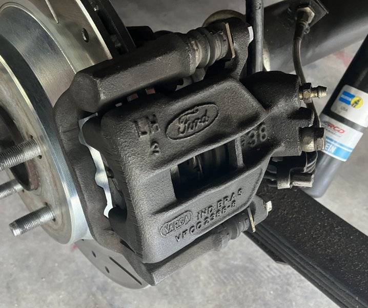

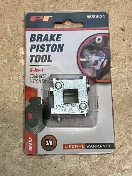

Your turn the piston in to retract it for new pads, generally trying to turn it out doesn't do much because there's a one way sprag built into the piston... pushing it out is typically accomplished by repeated application of the parking brake and the normal brake.... The piston has a inner hub with Acme threads, that attaches rotationally to the piston through a sprag but it directly applies thrust which is how the parking brakes are applied... The lever that the parking brake cable attaches to acts upon an acme thread screw that is inside the caliper...
