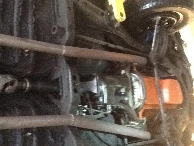

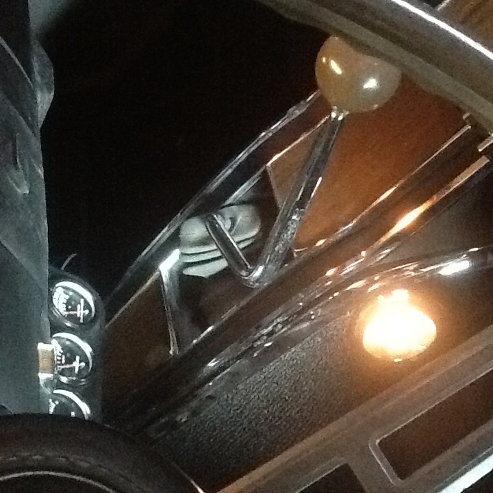

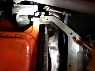

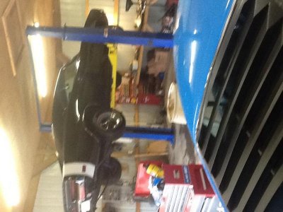

:glasses10: So the car is on the lift ready to go. I wanted to get a few pics before I take out the A-833. The 5sp set up will be here in a few days.

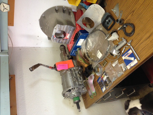

I purchased a RS600 from another member of the forum got6pak a few days ago. It's on another post with pics of all parts but I don't know how to move the pic to this thread.

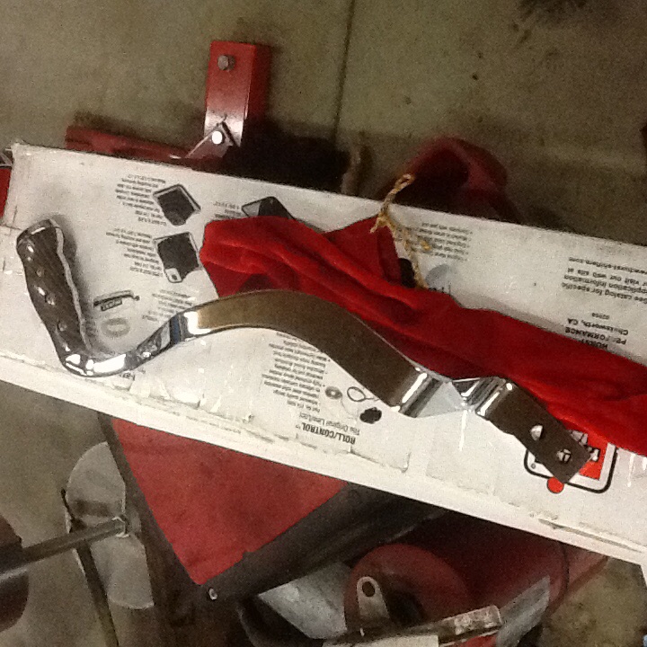

Here is a pic of Shifter Handle I got from passion performance. I was going to try a A-855 but was told 10 months before I could get one. I found this other set up and the price was a lot better and he had it in hand no wait.

Is this a Richmond? Sorry not familiar with the Model #.
Google tells me it's a Keisler

5sp RS600
No the handle is only 4 speed on lens.Im hoping the other one with the kit does.

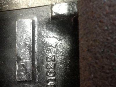

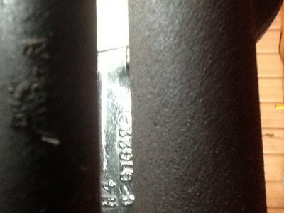

Can anyone tell me these numbers ID match
a 69 charger 383 4sp

From what I understand but not sure -Legend gears is who made this RS 600 for Kiesler :thinker:.
That handle will not work; it's bent/formed for the 4 speed side linkage and all RS/SS/Legend/TKO units come up through the tunnel on center. That handle will be on the passenger side of the tunnel when installed.

Cutting is indeed required on all RS/SS/Legend/TKO installs because the shifter comes up through the tunnel on center instead of through the shifter hump like the 4 speed. If you have a console, specific handles are required with an adapter to keep the handle in the console. You'll also need a small sheet metal patch to seal off the old shifter hump.
