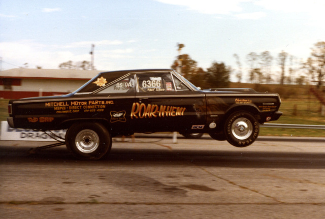

I know S/S springs work, Look at picture Phil Rohr. The Stock & Super Stock guys ran them for years. You might call Dan Devorak and see what they were doing with the springs. I know we ran the S/S for the first 3 or 4 years we had the car. We were told that since the S/S springs are not made of US steel anymore they are junk with in a few years. (For what that is worth)

Here is a picture of how super stock springs can work. Man Phils car really launched.

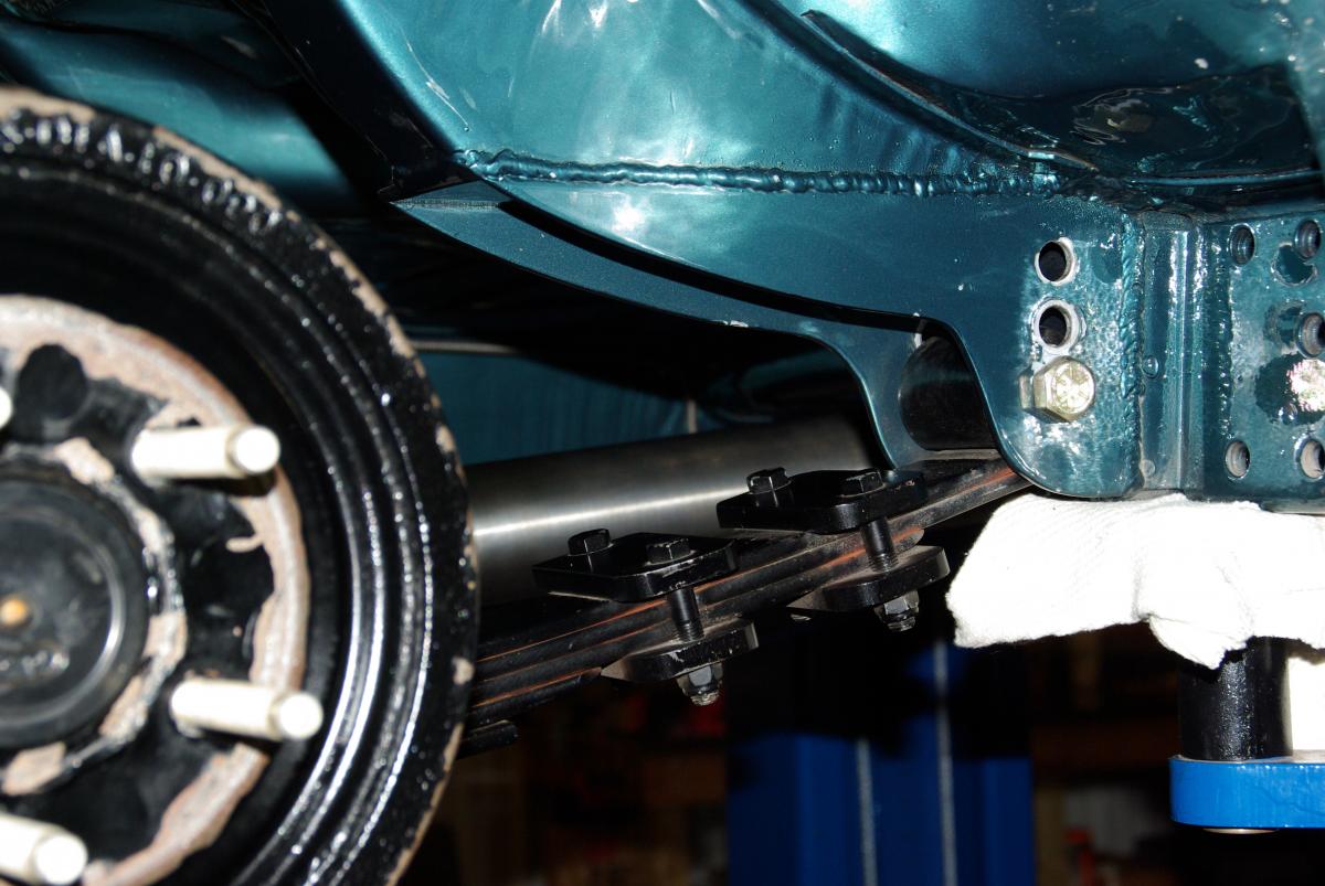

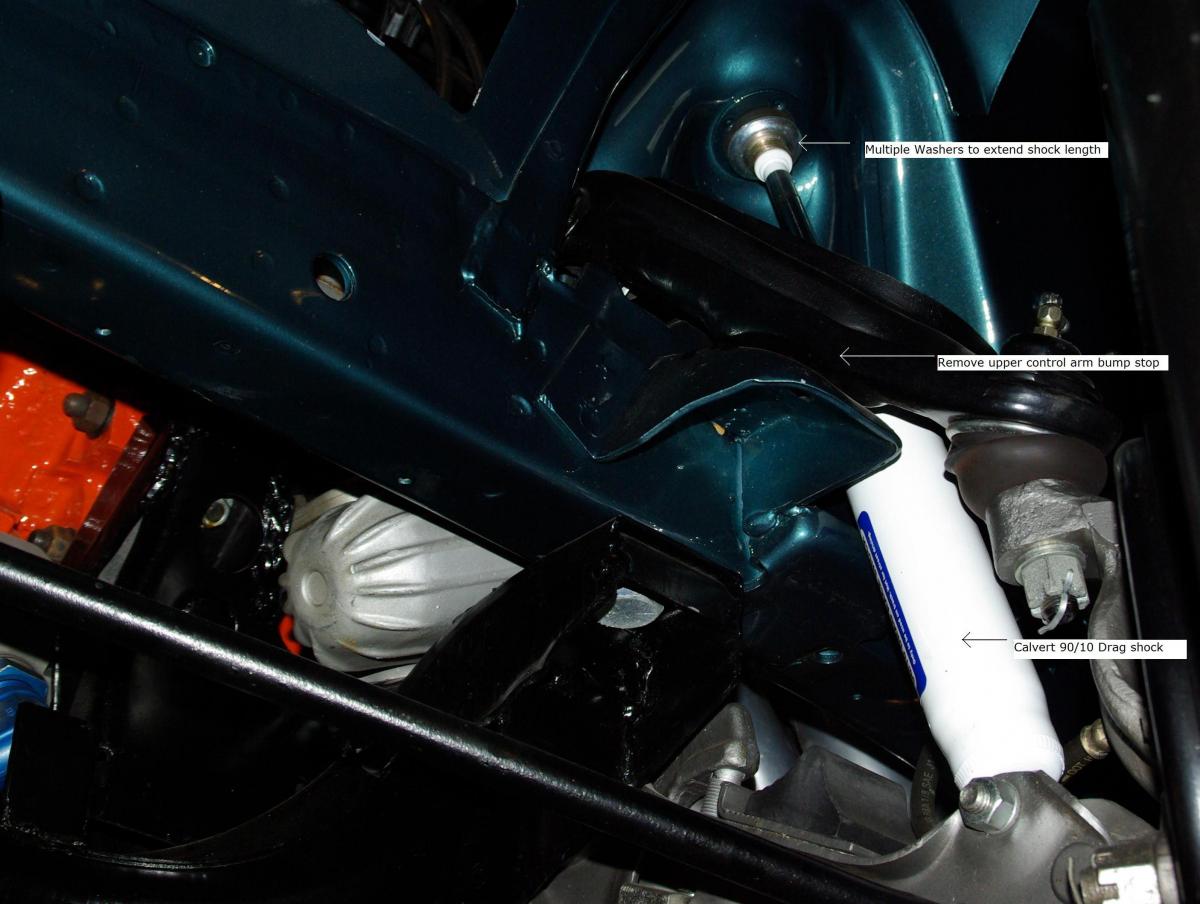

I'm running QA1 12-way adjustable rear shocks on my car. I just purchased the 9-way adjustable shocks from Calvert, so I'm anxious to try them out. I run 002/003 SS springs on my car that are moved in on the frame rails. I also have added an extra 1/2 leaf to the front segment on the right side to prevent spring wrap and torque roll. I do not run a pinion snubber; instead I have 3 clamps on my front segments and have my pinion angle set at 6 degrees. I clamp the rear segments depending on track conditions -- more clamps = less body lift for sticky tracks.
On the front suspension definitely remove the upper control arm bump stops and add washers to lengthen the shocks. I'm running the Mopar drag torsion bars.

Notice on the first run that my shocks are too lose and I bounce the rear tires and loose traction. The next runs I get the my shocks and springs set correctly for the track.
