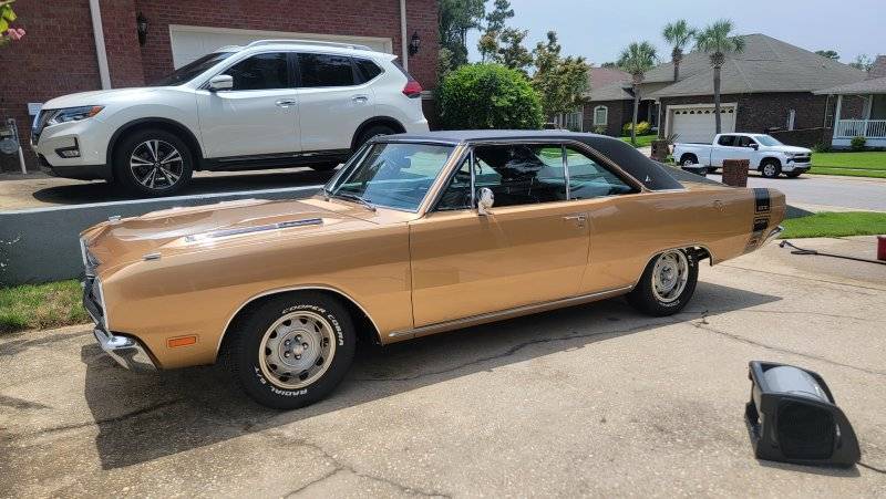

Help need advice...I bought this car last Oct. Paid alot of money. I want it to be a cruiser 340. Not looking to drag race. Love the power but want to take on a road trip next year. The car has 45000 original miles. It had a 3.55 gear in when I bought have now paid someone to switch to 3.23 gear and it whines bad. Didn't change the whole center piece cuz didn't know better. Since have learned that's how it should have been done. Should I keep 3.23 or put 2.93 this time for road crusin? It's going to have to changed so want to make right decision. Factory was 3.23.
