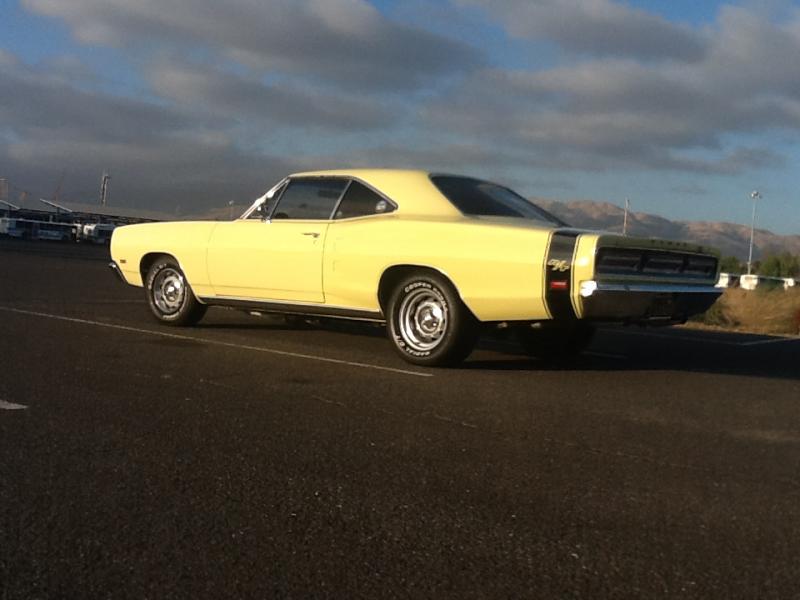

Here is the before picture. Note the height of the quarter to the rear wheel.
With the new springs, I was also able to get the front end a bit higher

It was actually a pretty easy job to switch them out. Do one side at a time so everything stays where it belongs. Hardest part was getting the front eyebolt lose due to paint and rust, I bought new front brackets instead and gave up on the old.
So except for the parts that I ended up ordering for the front, it took less than a day to do the whole job. Only part that came off the car except the springs and hardware were the tires!
a bigger rear tire :headbang:

That is one bad *** car and the height looks perfect in the back. Just a personal thing but maybe lower the front a tad (curb height) and it will give you the look that you want. Otherwise, the car looks perfect to me...!!!!
I want to get the car sitting a little higher in the back. Not sure what spinrgs are in there now. attached is a profile of the car..looks a little low in the rear.........Any suggestions?? I was looking at the Mopar performance heavy duty springs made for 440/6 and Hemis.....

I brought my springs to Perth amboy spring works in NJ 732-442-4420 and told them to add a leaf to meet my height requirements - they hit it right on. It was about 50 bucks if you bring them the leaf springs off the car. Re arching does not always work, they sometimes resag.
I was looking for higher than stock height on my 73 rr
Ralph
I will look into that..thanks
sweet ride!looks good like it is to me.my 69 sits just like yours.i kinda like the high aggressive front.
Just a thought here but what about the front spring hangers with multiple holes. Using the lowest hole will raise the body an inch or two. If you dont like it you can go in the stock hole setting. Cheaper than springs too.
