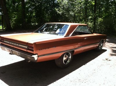

I was incorrect before. I did Eaton Springs, 1 inch over stock.
Here is the after picture of the GTX
Man! That stance looks PERFECT. You say you did Eaton springs ordered stock plus 2 inches high? Do you need to specify HD like if you order from Mopar Performance? If I wouldn't have seen that AFTER photo I would have thought + 2 inches would be too much, but it looks great. Can you please tell us what size tires front and rear you are running?

1 inch. No special requirement such as HD

Thanks for posting this. I was on the fence about XHD or S/S. Now I know the S/S is the way to go. Your car is still awesome, btw. It's one of my favorites here.
