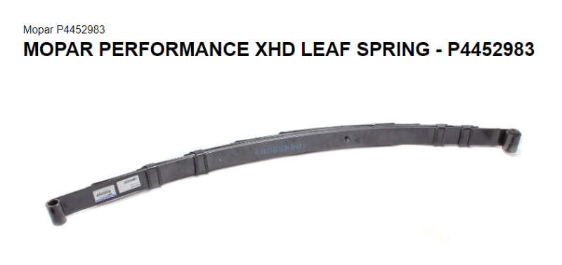

thinking about ordering a pair of these and doing the ISO delete at the same time to accommodate the different size locate pins. These will most likely have a higher ride height and I can adjust with lowering blocks.
I got rid of the ISO suspension in my Magnum. I cut up some old engine brackets because there nice and thick, the same as the large hole area for the ISO mount rubber area. Made circles and drilled a hole. Welded it in and used SS springs. I also used a 2 inch aluminum block to drop the rear of the car to get rid of the stink bug look. The springs are the 3600lbs SS springs.
It now looks level. I’d rather opt of a 1-1/2 thick block to give the car a minor rake.
The ISO delete is a priority along with switching to the older style lower shock mount plates so I can use normal shocks.
