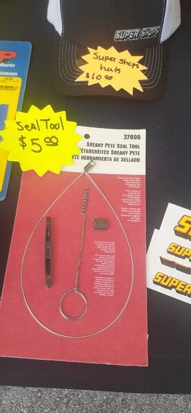

The seal retainer need's RVT in the corner's where it meet's the block. Off set the rope seal where it is not in line with the retainer half's. Also put RVT on the ends' of the seal packing. These are the most common source of leaks' on rear seal's. Their is a kit that you get a wire to pull the new packing into place. Hope you find the problem. A rear main seal leak is a Pain for sure.

Where would one get this wire accessory to pull in the new seal into place. This would def help replace the rear main without removing the engine.

Aluminum mig wire work's pretty good. Put a small hole in the packing and fasten the wire to it. Once through your top retainer cut the packing free of the wire.
