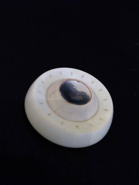

There were two styles. The early ones were a lot fancier than the more common ones. The early style are next to impossible to find. The pic below shows an early one but it's missing the silver paint they usually have.

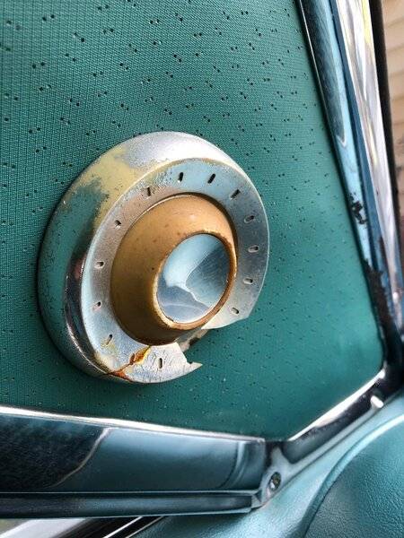

Mine are trashed

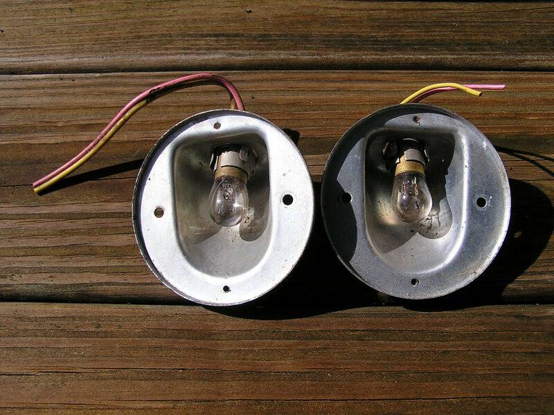

Shown is a set of the later buckets.....

Mine are trashedView attachment 979897 View attachment 979905

They are very fragile and most of the ones I've seen are broken.
Sorry, but Van's is wrong about them being interchangeable. At least not without modification to the buckets. The difference is the "newer" style mounts with screws. The "older" style (like yours) mount with plastic tabs on the back of the lens snapping into holes in the buckets.
By the way, the one in my picture was for sale by a guy I was corresponding with a couple of years ago. He might still have it if you want me to check. It was just one, not a set of two, though

I bought a set of later buckets for $15.50 with the pigtails and ordered a new set of lenses and bezels.......one more thing crossed of the list.......now where is that Hemi????

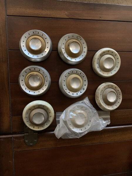

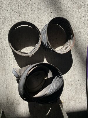

I earned that nickname for a reason. Those were just the ones I could easily find as I am sure there are more. Hence the problem I have now with way to much stuff. Seriously considered joining when they were having the discussion about using dryer ducting for connecting the blower motor to the heater box and I looked down and was like are these really that hard to find?

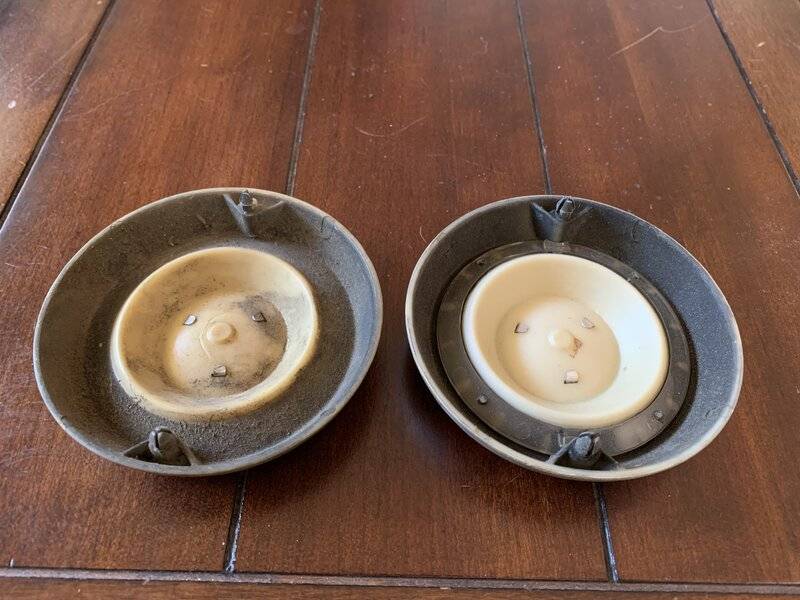

After a continued discussion with a member I thought I would post a picture of the back side. We were wondering why there is a difference between the 2 as some have a clear plastic ring and some don't. Anybody have a guess why? Missing, different vendor or Chrysler Dodge Plymouth?
Not sure, maybe a secondary supplier due to the breakage issues?
