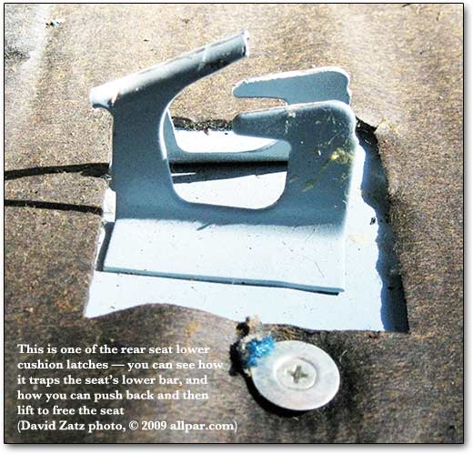

Taking the back seats out is fairly easy. The bottoms latch in two places on the bottom - push down and back on the front edge and it should pop up. Then you should see two bolts that hold the back of the seat on - take those off and lift the seat off the tabs in back.
I have the rear speaker switch but not planning on using it, and I have no rear defrost. Ok I have never taken a rear seat or any seat out before I was hoping to pull wires, if I removed the old rear speaker wire ,I guess this may not be a good idea.
Removing the bottom of the seat is really not hard. There is a latch on either side under the seat about 8 inches in from the outer edge, about 2 inches back from the front edge. Looks like this:
On the bottom portion (where your but goes) push down on the front edge of the seat and then back a little, and then lift up. You should feel it come out of its latch. then do the same to the other side. Once it's loose you can lift it out...it's easier if you remove the arm rests. To get the seat back out, lift the bottom outward then lift the whole thing up. There are hooks that it rests on. You will see all this once its out. Very basic stuff and should take but a few minutes to get them out. Once they are out there will also be a small pice of trim at the bottom of the rear side panel that will need to be removed (one screw). Now you can pull back the carpet along the edge and see the wires I was talking about in previous post.
Seat installation: put the seat back in a little high, side it down on the hooks at the top, then push the bottom in over the alignment tabs at the bottom. Put the bottom back in place and push back and down on the front part of the seat and it should re-latch in those hooks on the floor.

I and my son tried to remove rear seat, I know I am getting old and weak but my 34 year old son and I could not move the bottom front of the seat a 1/8 of a inch, must be a secret to moving it , will have wait until I meet some mopar people to show me this secret. Thanks for pic and help
