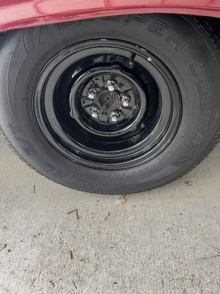

Good evening, everyone. I have acquired a 65' Coronet with 15"steel wheels front/rear. The fronts appear to be police style and have the same style center caps. The rears look similar but are also 15" and have a larger opening in the middle. The front caps are too small for the rears. I've also noticed the rears have three threaded holes in a triangular pattern (I'm guessing to bolt caps to?) Any help is appreciated.

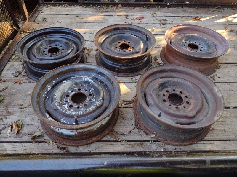

Your rears are the older style rims that takes the bigger diameter dog dish caps.
The fronts are the newer style rims with the smaller dog dish caps.
in 67/68 Mopar changed from 10 inch caps to 9 inch.
Finding 15" 10 inch cap wheels is extremely rare.
My bet (and judging by the look of the front, esp the squared off area below the bead) is that all 4 are aftermarket.
Rear wheels look to be of the Ford nature , because of the raised part inbetween the lug holes and looks like someone drilled holes for screws , to make a way for a 9 inch cap to attach to those wheels.
As was said 10 inch dog dish cap wheels are hard to find , unless you have a pair of my wheel centers and get them made into 15 inch wheels.
Frank
OK, I thought the pics were of the front.
I revise my opinion that the fronts could be OEM (but post 1967) if they are 14" and take a 9" cap.
I sand by my guess that the rears are aftermarket.

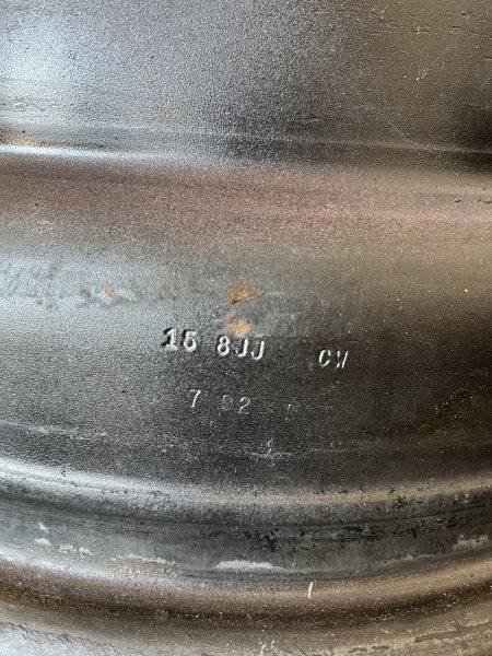

Thank you everyone for the replies. I was able to get some new, matching tires today and I got some numbers off the rear wheels. 158JJ CW are the markings on the inside of the rim. This mismatched stuff is driving me nuts. At least I got some new rubber on her now and they all match!
These are 14" x 5" wheels from early to mid 60's Mopar. They came off of a 6 cylinder 66 Coronet. They fit the larger dog dish caps.

no telling. im on a mission at this point and will figure it out sooner or later. I did look up the rim number until i was blue in the face and it appears to be a 15 inch, with 4 inch backspace basic steel hot rod type wheel. 4.5x5 if i recall. whatever the bolt pattern is. i just want to find two caps that fit.
You won't find a matching set of four caps with those wheels. You can find the newer wheels for the rear that uses the smaller cap like on the front. '66 on up. Or find the older wheels for the front and use the 10" caps. The rear wheels you have now might be an oddball just by a little that won't let you get the ones you found installed.
