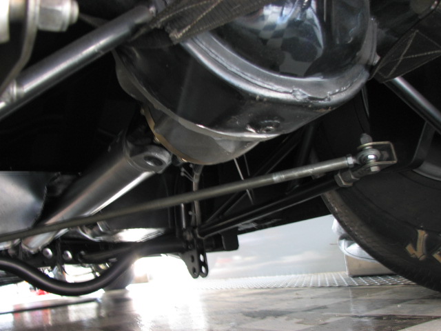

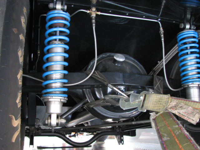

Here is a picture of the ladder bar suspension on my last race car. The ladder bars worked great once they were set up no need to mess with them. Most I would do is tighten or loosen the shocks.
It was a low 10 second bracket car.
It seems like for consistency, ladder bars are the way to go.
i have CT's and have been 9.0's on 28x10.5 tire's.
I don't have the anti-roll bar.

DA shock's in the rear at that time.
You can be very consistent with Cal Tracs. Look at most of the stock eliminator cars.

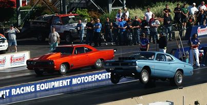

I vote Nova salmon and whatever suspension is in this car on the left. the blue one
