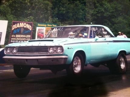

Bobtile here's when I was slow. Caltracs 10.21 ET with a 1.41 60 foot. In all fairness the frontend was tied down with front end limiters which I raced for years and didn't notice them until I swapped out new shocks.

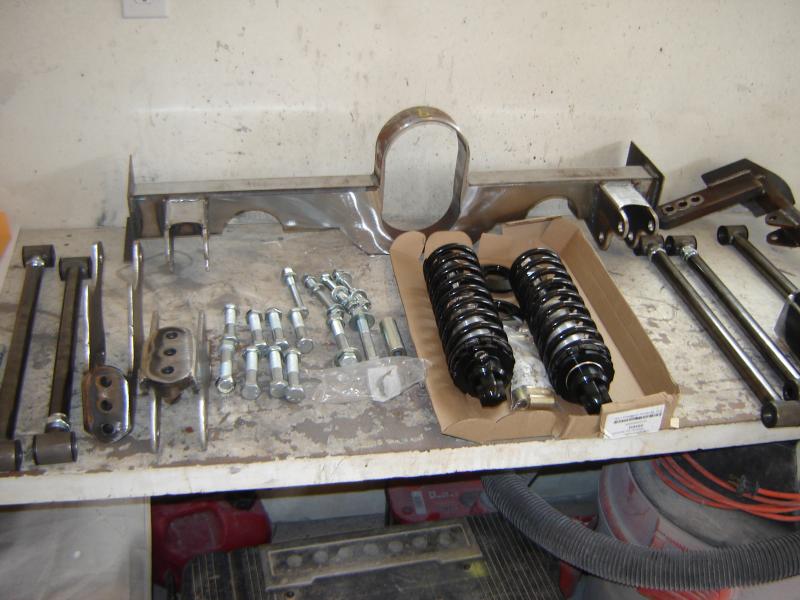

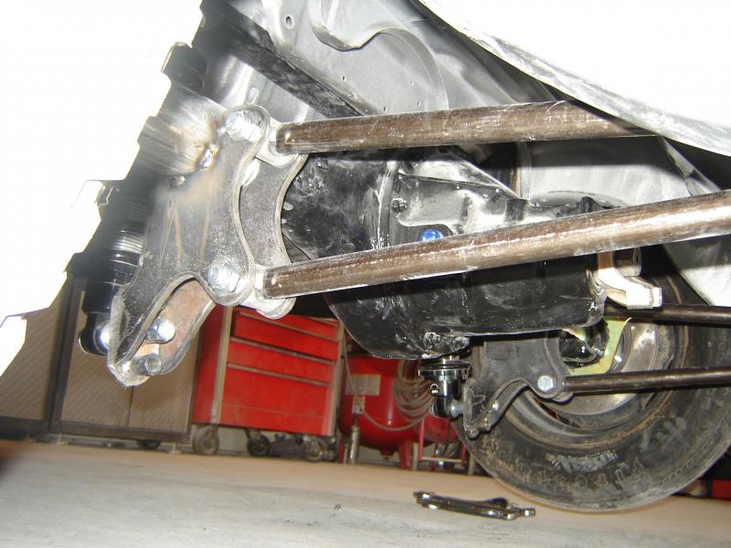

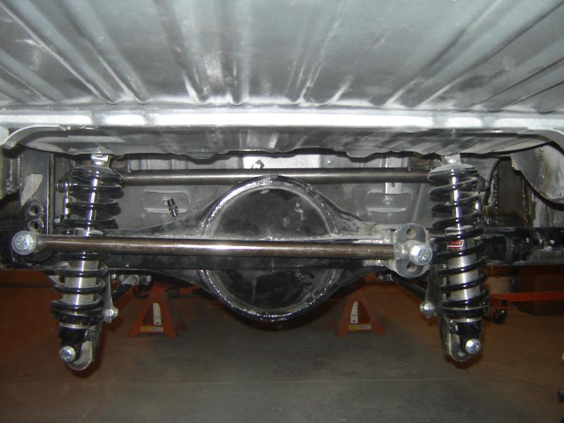

i ended up doing this adjustable 4 link setup on mine. I wasnt a tough install and its fairly adjustable.
What was involved? Rough idea cost-wise?
Its about $1900 all together with the coil overs, 4 link, brackets and track bar. As far as the install, you knock a section of the frame, weld on the brackets and box them in (it doesn't tell you that you have to box them, but I am going to be pushing big numbers), and weld the brackets to the rear end and the frame.

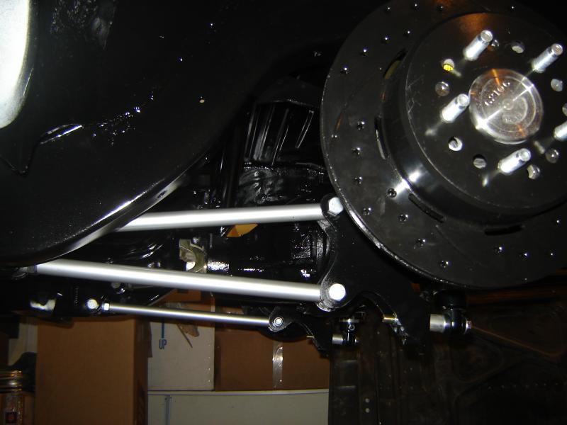

This is the four link I used on my 1968 Charger. It was pretty easy to install and it cost $1340.00 with there shocks $1580.00 with qa1 single adjustable.
I have not had the car on the track yet so I can't tell you track performance.
Here is a pic before installation. Hope it helps.
Thanks,Joe
I like the cross member added strength, and easier instal!
Doesn't look like there is any adjustability for the 4 link bars in that kit.
