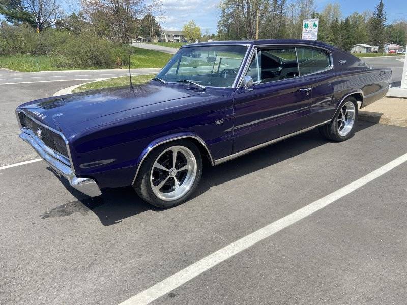

Curious if anyone has installed a rear sway bar on a 66/67 Charger and if so what kit was used. My car sways ALOT granite I haven’t insta The front one yet due to previous owner cutting off brackets on front controls arms when making it a drag car. I do have everything for front just need to do some welding. Thanks in advance

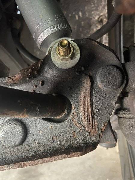

Thanks for that info. I pulled the sway bar off my parts 66 that’s we’re I seen the brackets plus I can see we’re they cut them off my cars lower control arm

It's possible to cut the brackets off one lower arm and weld them on the other. But doing it on the car might be tricky.

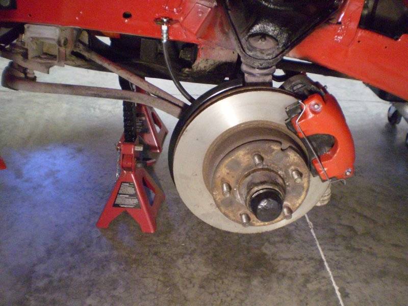

Found out I’m gonna have to figure something else out for my front sway bars. My car had calipers that are in the front of the spindle so my caliper hits it if I was to install it. Did all that work cutting off the ones off parts car and cleaning them and painting them to find out won’t work in original spot.

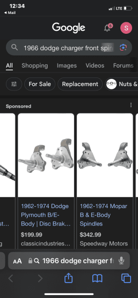

Spindles are interchangeable side to side, with no effect on geometry. Just hang your calipers out back. You will have to change your brake line bracket on the frame, from behind the top A-arm to ahead of it. I had to do this on my car, after I installed a front sway bar.

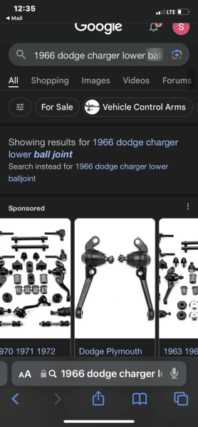

I was wondering about that but figured we’re the outer tie rod hooked up would be in wrong spot if I switched them
If you changed the spindles from side to side wouldn't that only move the caliper and not the lower ball joint/tie rod location as the tie rod mount is part of the lower ball joint?
I drove my granddaughter to a birthday party in my 66 Charger because she wanted to show all her friends her papaws car. So I will jack it up and investigate if it’s possible. My only worry was the tie rod were it connects to spindle.
I did some digging on the internet and it’s possible
