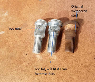

I have original R and L wheel studs with perfect threads....No one carries correct looking right hand thread and Frank Badalson has correct left hand thread available....If you want new right hand thread napa has them just bring an old one in the store.

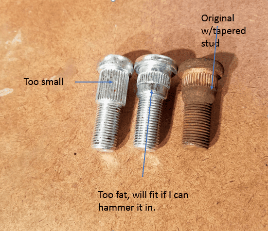

yah, that's what i did moparnation...the measured both old and new with a micrometer thingy ma bob. they matched Knurl sizing, but they are not tapered as per the originals. see attached. and i think that's why they are not going on.

You can but you don't have to pull out the axle to install wheel studs. Mopar makes many differ knurled sizes you probably have a .651 or .673 diameter knurl. You need to borrow a caliper to make an accurate measurement. Once you get the proper stud, I use old clutch pilot bearings but you can use washers stacked. Lube the threads and just keep tightening the lug until it pulls the stud flush. Turn the lug around use the flat side against the washers. They go in tight, it supposed to.

I just checked Rock Auto, for my year and model it's giving me a .671 Knurl. Let me head over to Napa tomorrow morning and ensure i have the right knurl size, i think they provided my with a .651, but i'll double check with them before yanking out the hub.

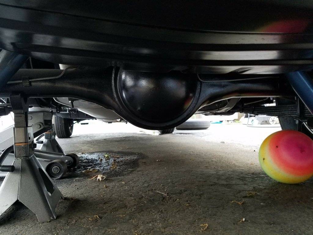

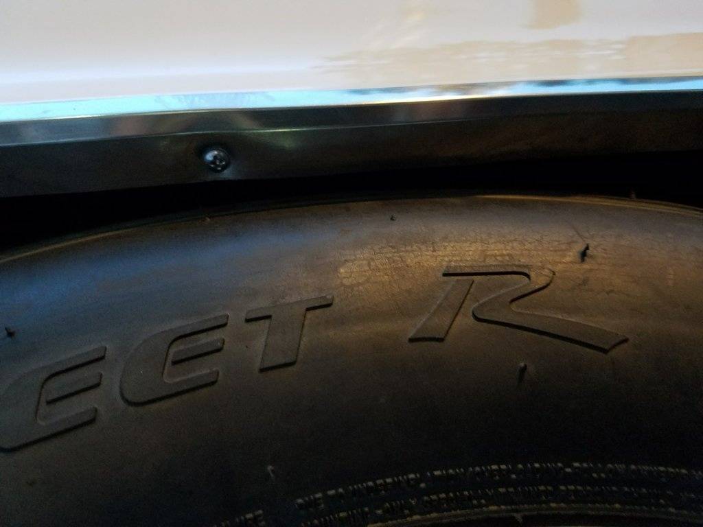

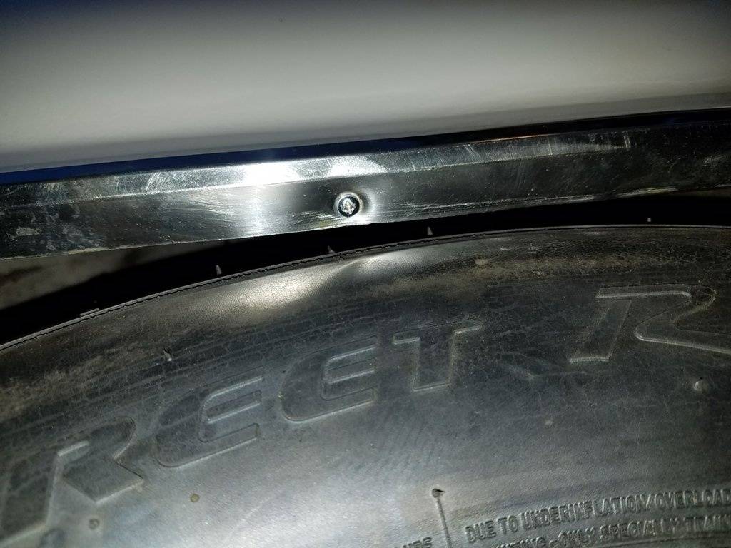

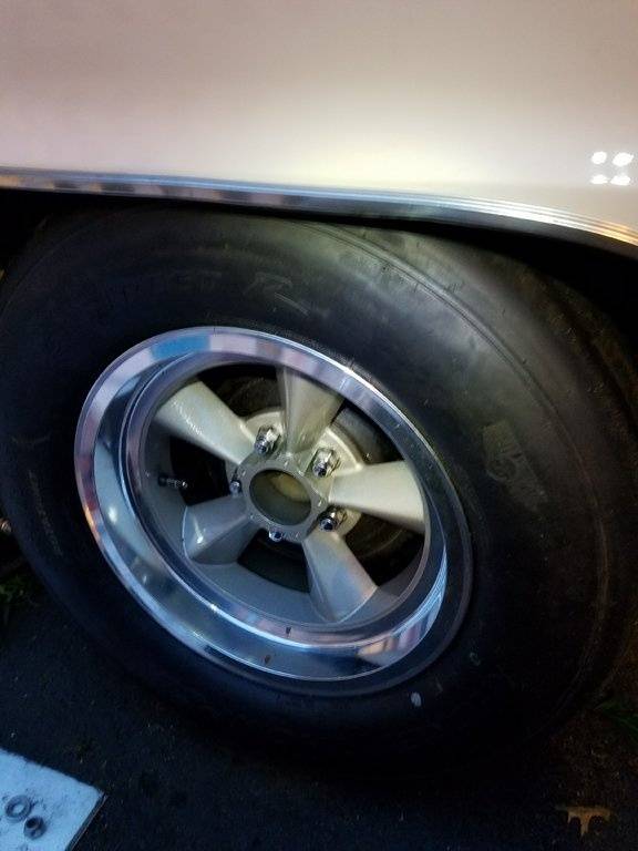

Bad news is that the wheel arch just touches the tire when lowered!!!! :( the passenger side has at least 1/2 room to spare, although i was definitely planning on getting the wheel arch rolled to just to ensure there will be extra enough room.

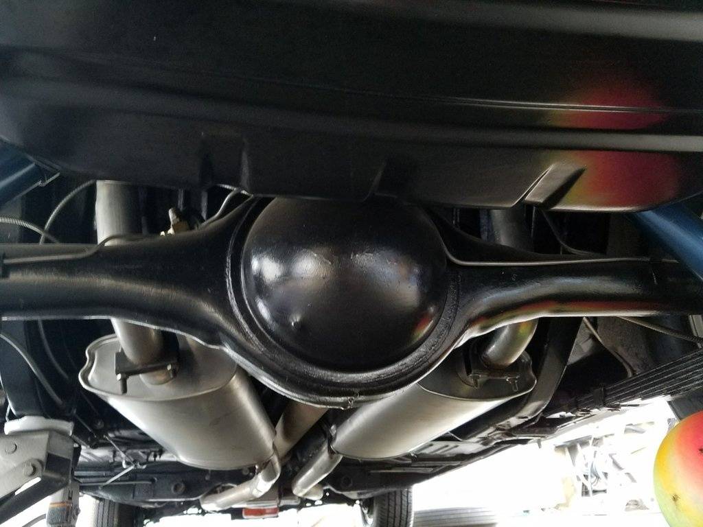

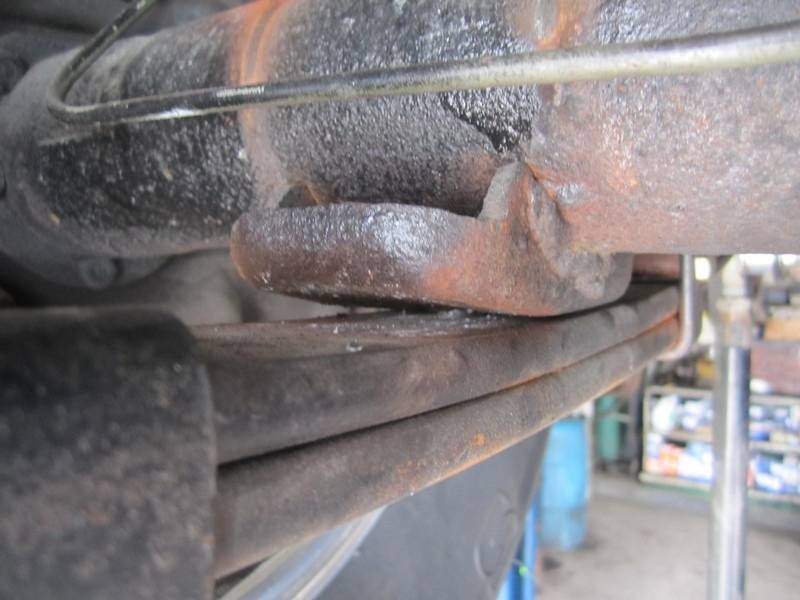

I'm assuming that the rear-end is not 100% centered....any thoughts or suggestions would be appreciated. i took a few pixs of the driver side-tire that has less room, hopefully they will show the story.
best, Paul.
To rectify your issue, a new set of spring perches are in order for you to square the rear.:thumbsup:

View attachment 426068 View attachment 426069 View attachment 426070

Spring perches....let me check into those...would they change the height in anyway? hoping they would not elevate.
For the studs, i oiled them and then used a stack of washers and standard nut. i tried using my impact tool, but my arms proved stronger using a pipe on the end of the socket wrench to increase torque

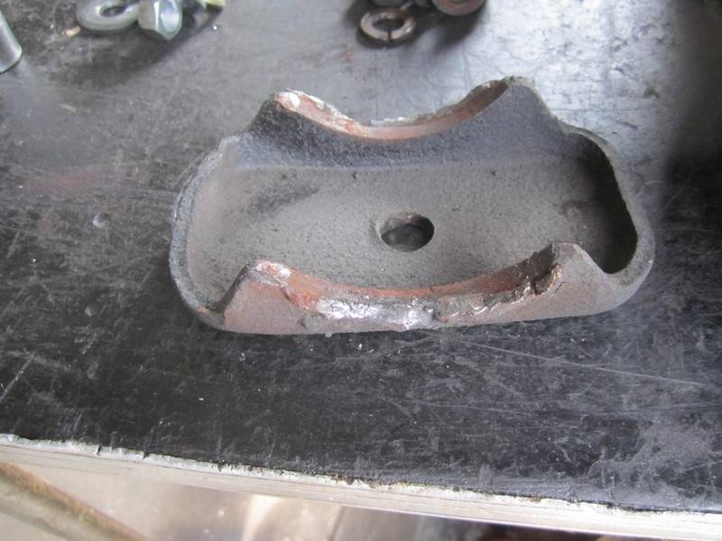

I know they make a several reinforced perches.When I twisted mine,I had a stock set in stock so I used them and reinforced the rear side of the perch.

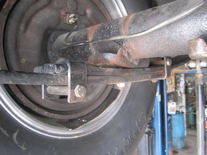

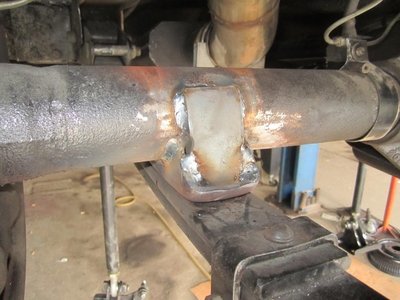

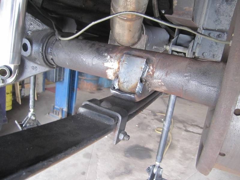

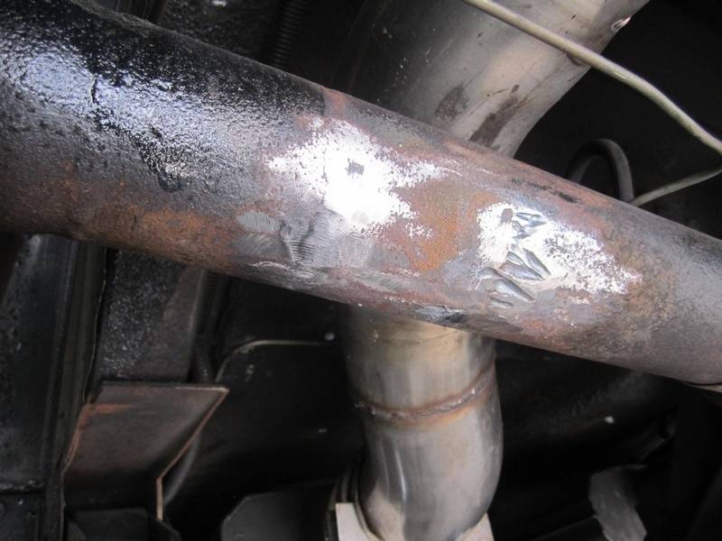

8.1.14 001.jpg 8.1.14 003.jpg 8.1.14 004.jpg 8.1.14 005.jpg 8.1.14 006.jpg 8.1.14 009.jpg 8.1.14 012.jpg 8.1.14 013.jpg 8.1.14 015.jpg 8.1.14 017.jpg
