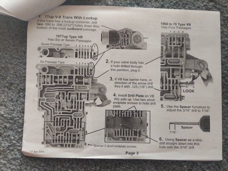

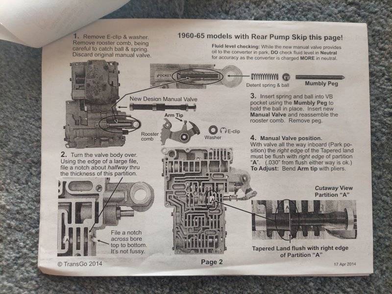

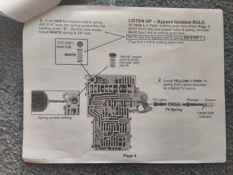

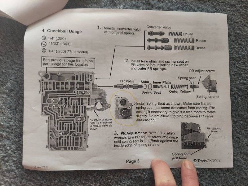

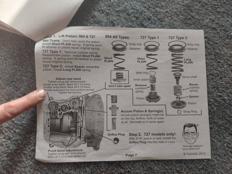

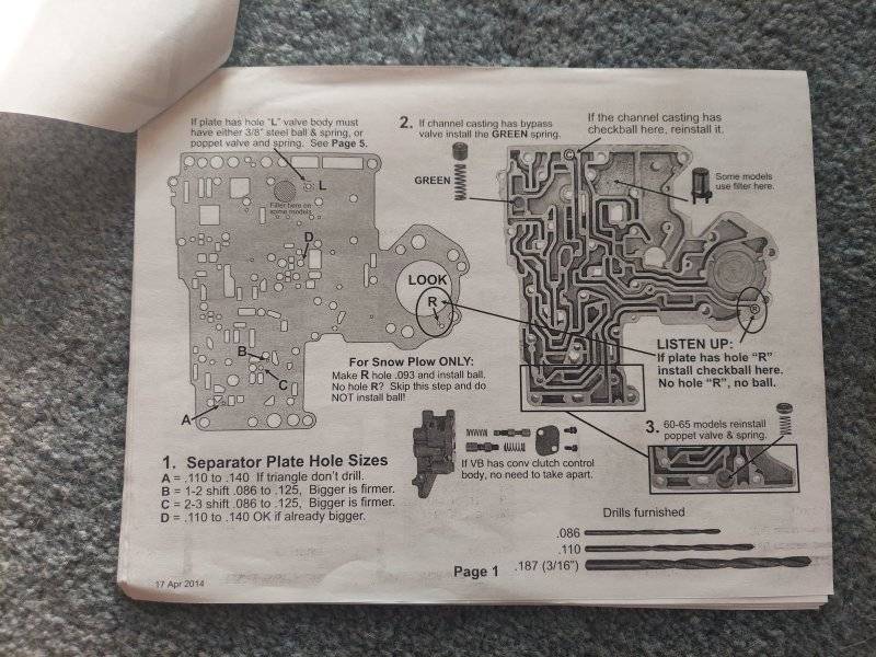

Ok. I will try a couple things. Thank you. Now....I am not a professional and I don't know half as much as most people on here. I'm just posting the instructions in case someone doesn't have access to them or is just curious. I also notice that the fsm and transgo say 2 1/2 turns out on the bands?
Follow their instructions, it also says to remove the restrictor in the front clutch apply if the rpm flares on the 2-3 shift. Follow the instructions and adjust from there.
