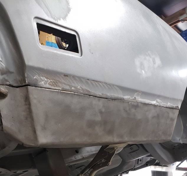

I'm looking for a good sheet metal brake that won't break the bank. At the moment I need to make the top piece of the outer rocker panel where the sill plate is attached and am using 18ga sheet metal. It needs to be 34 inches long, however a metal brake that can bend a piece of 18ga that long won't come cheap, so I would be willing to make 2 separate shorter pieces and weld them together. AMD wants close to $300 for the outer rocker panel and my panel is amazingly clean with exception of the top that rotted out. I considered going ahead and buying the panel from AMD, but thought that I may need to make other bends on my project. So invest in a good brake?

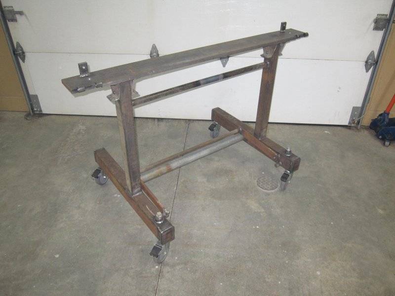

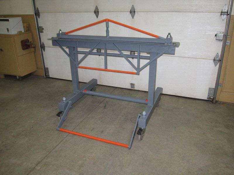

I wanted one too. So, I built one. It will do 48"+.
I concur with using a SM shop. I have had drive shaft tunnels built for projects myself.

I had to improvise .... The lower patch panel is no longer available on the RT side. Sharpen the lower edge after weld up.

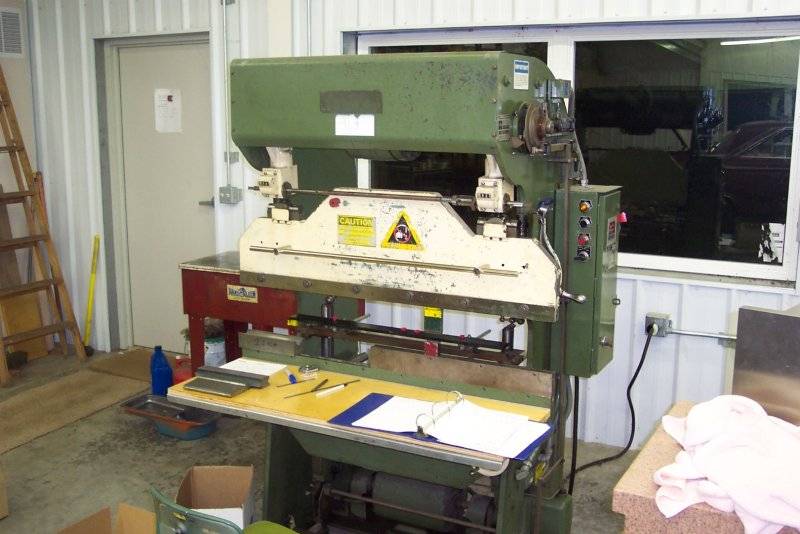

I have a 4 ft Diacro in my home shop. It makes short work of bends. The trick is to round up all of the necessary tooling for a job. The tooling can be expensive if you have to buy long die sets.
