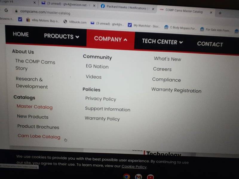

Yeah I know, I have a copy, but the .904 lobe section is really limited from Comp. I would hope they have a lot more .904 lobes numbers than what is in the catalog but you probably have to call to get them.comp cams has a master catalog lobe profile too
