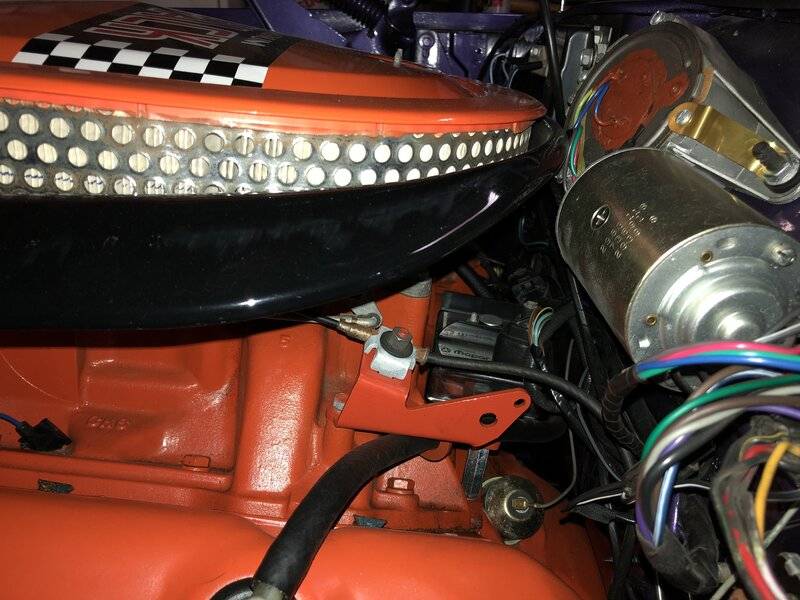

I made a bracket that bolts to the rear of the valley pan under the air cleaner because I don’t want to see it.

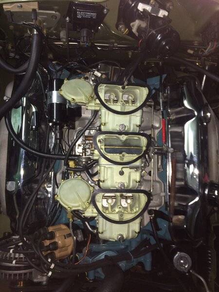

Here’s some better photos. Really a simple thing to make.

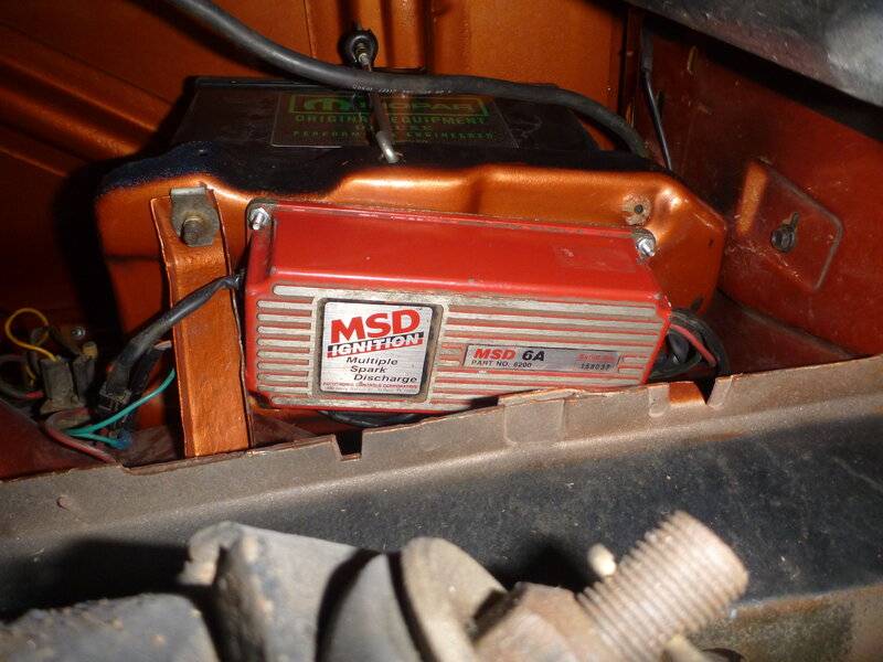

I mounted mine low on the radiator support pass side.... 68 Charger.
Best hiding spot I've seen yet for an MSD system.... on the Dart I just bought.
