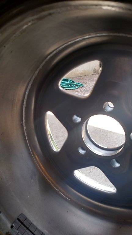

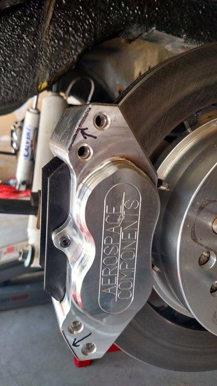

Found out what it was, the rear calipers are hitting the inside of the wheel. Either gonna put washers or get rear wheel spacers
Found out what it was, the rear calipers are hitting the inside of the wheel. Either gonna put washers or get rear wheel spacersView attachment 428658
Get a high quality spacer, no washers. Billet specialties makes a nice spacer for about 30 bucks from summit. May need to go with the 3" wheels studs if you don't have them already
I actually didnt want to push the wheel out any further so as painful as it was I took a mini sawzall to the calipers lol . All is good now .... Still alittle under whelmed with the braking performance, maybe I had my expectations set to high but I was expecting corvette z06 stopping power . The manuel brakes are surprisingly not to much different in terms of pedal pressure than the power I had
Where I cut about a quarter inch block out
They're good brakes, but corvette or any other modern sports car is setting the bar a bit high them cars have 14" rotors with 6 piston calipers, there's a reason the brembo kits are $5,000+
Thanks, that's actually the before picture. Next time I have a wheel off I'll snap a picture of them cut. Those are my thoughts exactly I really didn't want to run spacers at .my only concern is the placement of the master cylinder rod on the brake arm. Aerospace wanted me to drill a new hole at 1.62", I used to existing hole at 2". Not sure how much if any stoping power I lost.
Looks better than I thought it would, me personally I would have done anything not to run spacers on my drive wheels

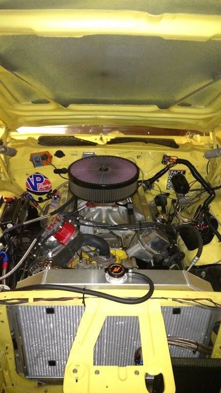

The new master cylinder actually cleaned up the engine bay way better
