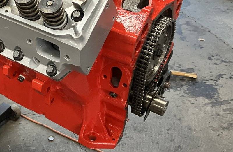

The pushrod will not fall out. To get it out, you have to remove the pipe plug in the block. The plug is below the hole the fuel pump bolts up to.

My small block does not have a plug, nor a push rod for the fuel pump. This is likely the case for that 318 of yours as well.
