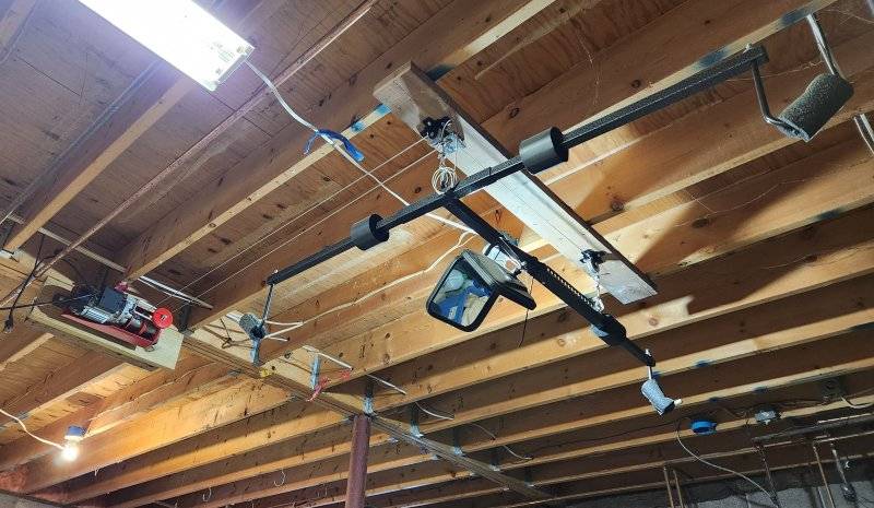

I have one of these Jeep hardtop winch things. It would be relatively easy to make some brackets to adapt to an A12 hood. And if I happen to come across one, I will use it.
Jeep hardtop are several hundred pounds, so I don't see an issue with weight.
