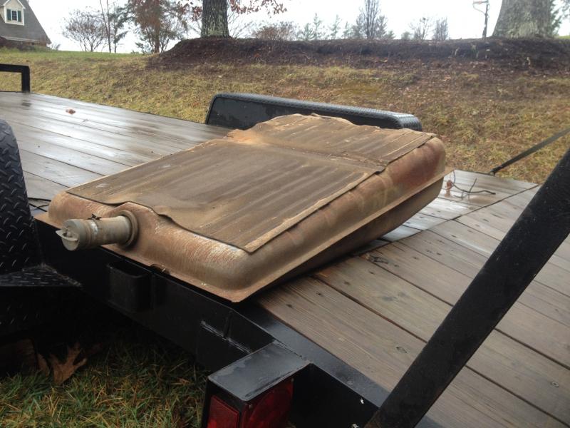

IMG_2920.jpgGot the gas tank out and cleaning it out, the gas looked like pink lemonade, soaking it in Acetone for 24 hrs. How long and how would you guys recommend letting the tank air dry. I am sure you want to get all the water out when finished. Also, would you guys recommend replacing the mat that covers the tank?

Spray the tank with some POR or such to help prevent rusting the tank further.
I folded over (triple) some tar paper to isolate the tank from the frame and while your at it, please change the fuel sock on the pickup while you have the tank out. You'll be happy you did it now.

POR is a sealant that goes inside the tank to keep rust at bay.if you cant find it at any local auto parts,try some local radiator shops.they will some times have the radiator boil out service with a reseal deal.
fuel sock is the strainer that goes on the end of the fuel pickup to prevent getting garbage from your tank into the fuel line.i dont think the early modle cars came with on though.my 67 coronet didnt have one.
I did the one in my 69 RR, and the fuel line/sending unit coming out of the tank was completely plugged. Prob to gas evap in the tank for 12 years. They are available as a unit. And put on a new filter sock 4 sure. The RR used a 5/16 line, I put in a GTX one which is 3/8 diam I believe. Also be sure to put on the ground strap that hooks to the metal fuel lines and goes past the short rubber fuel line coming out of the tank. Otherwise the gas gauge wont work.
