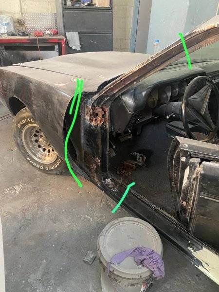

Hey guys, I'm pretty new to car restoring, and working on a charger 1974.
My body shop guy asked me to see if I could find this part/pillar since it's not fixable as you can see on the picture attached.
What do you think are my options to fix this? Look at a junkyard? What "part" or pillar should I be searching for?
After some googling I believe it's called a "door hinge pillar", but correct me if I'm wrong.

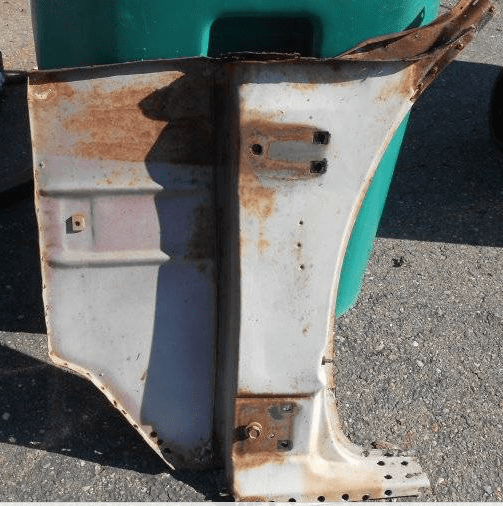

You may want to check with AMD (Auto Metal Direct) for a repop piece. But I'd try to find a good original piece from a donor car. Something like this...
That panel wouldn't necessarily have to come from a Charger.
Could come from an E-body, or a Roadrunner/Satellite, Coronet, even a B body station wagon.
Yes, that's a A-pillar or hinge pillar as you stated. Get a clean oe part from ^^ moparmarks , the body man will section it in at the windshield post and the rocker panel for the proper repair.
AMD doesn't seem to produce one for the charger 74, I can't find any 70-71 A pillars there.
I'm out of the left side. Have a couple right ones.

Body guy sent me this picture to better represent where cuts would be ideal. I found one from eBay and he quoted 300 + shipping from Texas to San Diego.
For 300?, thats not bad. Someone has to cut , box and ship. Make sure its clean enough to use prior to purchase.
Just a note that the A-pilar is at a little bit different angle on a 4-dr than a 2-dr so be sure to ask what it is off of.
