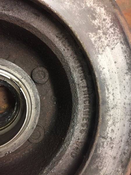

Hey guys,
During rebuilding my front suspension i noticed that i have 2 different types of rotors up front.
1 is OEM (2 piece) style and the other one seems aftermarket from an unknown brand.
When i was checking wheel alignment i noticed that the wheels have a bit difference in offset compared with the body.
As the rims etc. are same i guess this is because to different rotors, during bearing replacement i did find a home-made spacer behind the outer bearing race on the non OEM rotor probably for the reason it is not an exact match.

I have 2 different ones, the passenger side is a 1-piece replacement. (not sure if it is a correct one though)

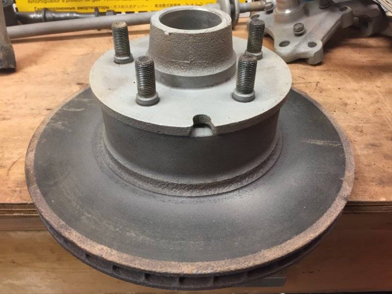

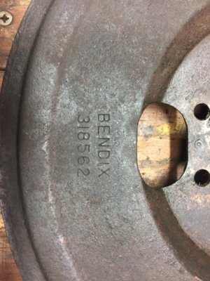

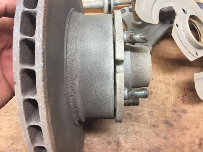

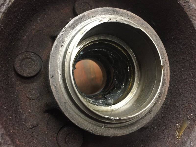

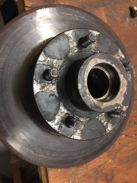

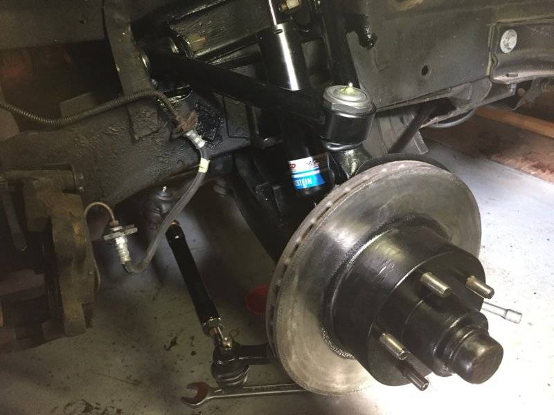

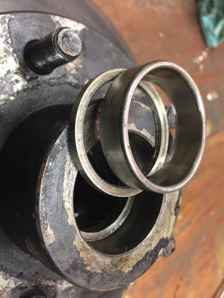

On the pictures below, you can see the spacer i found below the outer bearing, this is a 1 piece rotor.
This rotor is installed on the passenger side.
On the driver side the blasted rotor was installed, this is a 2 piece rotor, no spacer was found.
So to my believing, the driver side is an original type and the passenger side is a reproduction type which replace the original.
As the 2 piece had some issues with distortion due to heat etc, the single piece was a better option i guess.

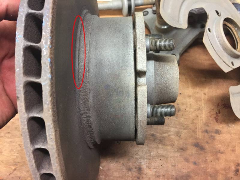

Now looking at it, this 2 piece rotor might have been machined down as well....looking at the lip that appears to be machined. :wtf:

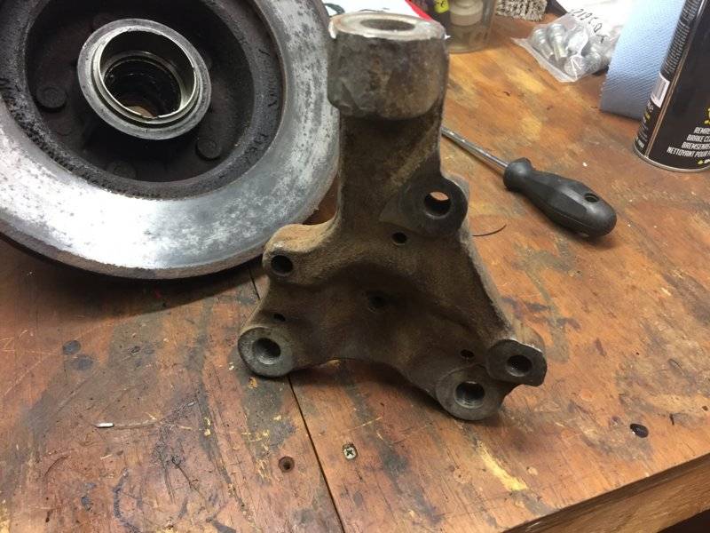

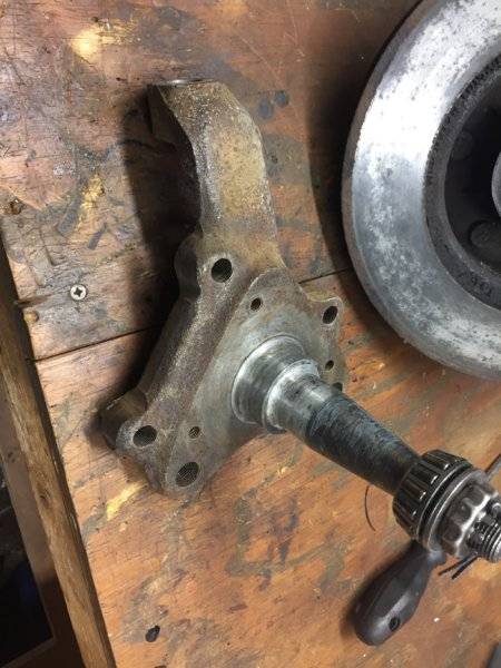

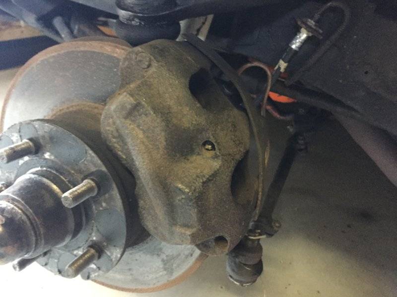

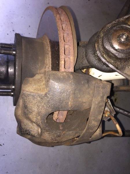

Can you take a couple of pictures of your spindles, (knuckles) and calipers, and post them?
Want to see what exactly you have.

I have never seen any type of "spacer" behind a bearing and race before, so i ain't got a clue what reason you have that on a car, but if we keep working on this problem, it just might get figured out.

Regarding the spacer, i think this was added behind the outer bearing to prevent it from going in too deep in the hub.
Once it would be seated all the way in without spacer the locking nut will be on the end of the thread and not locking in both bearings.
To compensate they added this spacer so the bearings are locked in.

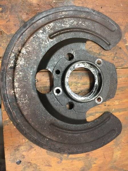

See below some pics of the calliper and spindles.
IMG_9028.JPG IMG_9030.JPG IMG_9073.jpg IMG_9146.jpg IMG_9160.jpg IMG_9164.jpg IMG_9165.jpg IMG_9153.jpg IMG_9152.jpg
