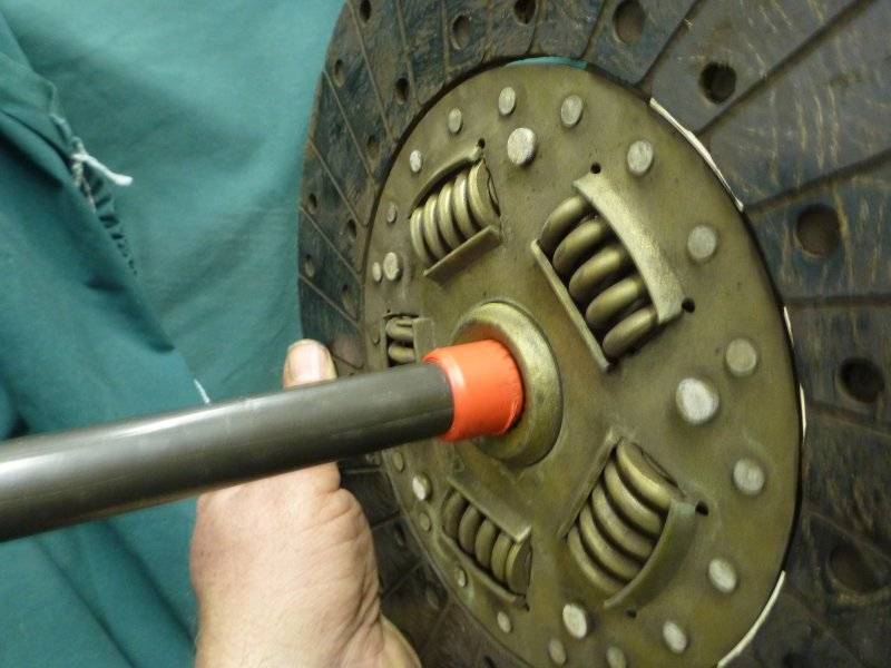

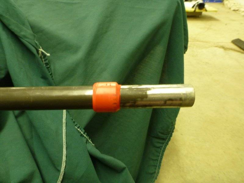

There's a thing we used to call a "butt plug" that has splines and is the correct diameter to engage the seal.
Parts stores sometimes stock them, but only for chevies, of course they won't work on a Mopar.
Should be able to order one.
Usually red plastic and should be fairly cheap.

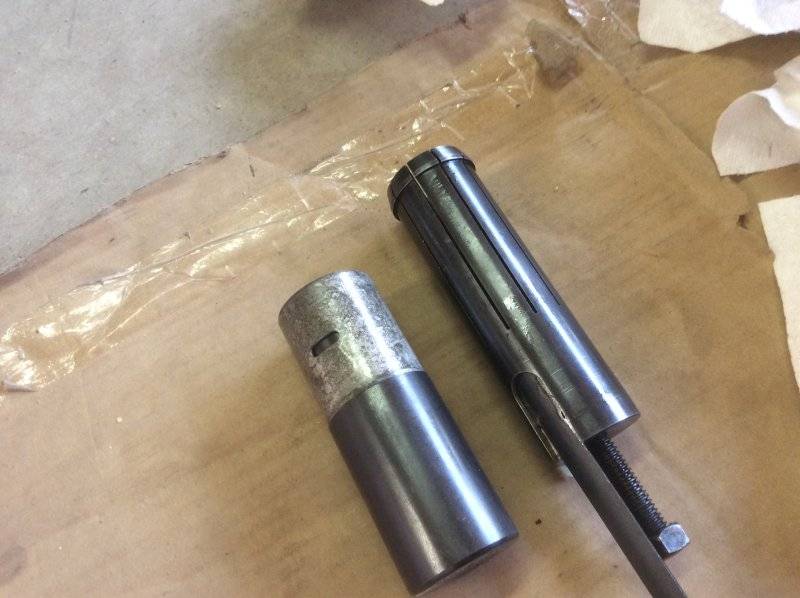

This is the tool to change tailshaft bushing. If you go to a trans shop they should have the tool, works on furd C6 trans. Once they get the tool and wrenches it only willl 10 minutes. There's a bushing on driver to install bushing.
