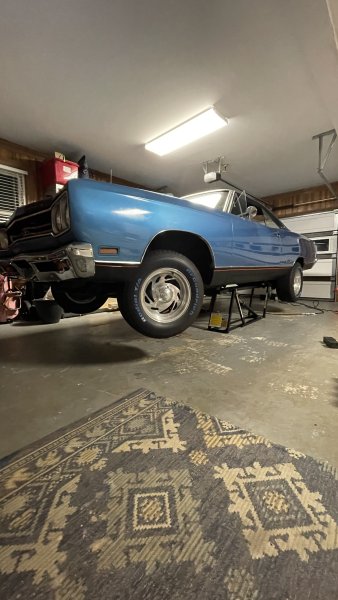

Hello, I’m starting a project to replace my clutch and flywheel in 69 Plymouth GTX. Original 440 motor with what I think is a 4 speed A833 out of a 68 Roadrunner. Anyone have any tips or guidance on the process?
I can’t find any videos on YouTube of this happening in the car. I have a general idea of the steps but don’t want to do anything I don’t have to.
Here are the steps I’m considering:
Detach boot from shifter
Pull drive shaft out
Unhook reverse wire and speedometer.
Loosen bolts on transmission
Support transmission with jack
Take off a cross member
Pull transmission back and down
Remove clutch and flywheel
Remove pilot bushing
Then go in reverse to put new stuff on.
I don’t know the spline count and diameter of flywheeel so waiting to see before ordering parts.
What am I missing? Probably a lot.

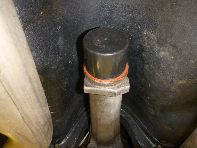

Can I just shove some rags in?
I like to shove a bunch of rags around the seal then slip a plastic bag over the whole mess and zip tie it around the the tail shaft.
You will still get a little leakage but not much. It's not that difficult. Your punch list above covers the basics. Easier with two guys. When I was younger I did several by myself without a tranny jack.

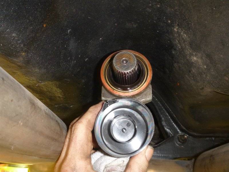

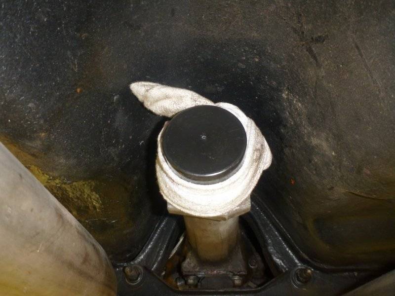

Well ain't that slick. What the hell is it Dad? It would probably be a little slicker if you didn't have to tie a rag around it.
Oh!!! Rattle can lid!?!?! Canadian ingenuity. :drinks:
Yep, just a paint can lid. Jammed on, taped and a rag for good measure.
