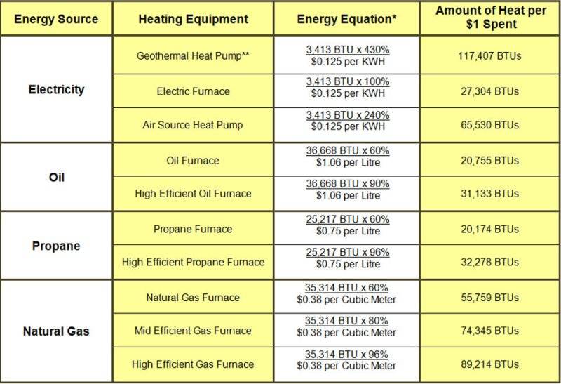

Well, this has turned into quite the mental gymnastics. I live in the northeast (near Buffalo, NY) My current oil furnace and air conditioner are 22 years old. Since oil furnaces are going the way of the dinosaur, and are being phased out completely, I started looking at my choices. I have had 6 HVAC sales people out.
1. High Efficiency LP furnace and central air conditioner.
2. Stand alone Air source heat pump.
3. Hybrid system which, as the name suggests, is a heat pump with a propane furnace for backup heating when the temperature is @30 degrees Fahrenheit and below.
The first choice is the least expensive option and would save money as fuel oil is way more expensive than propane. It is also the simpler solution that would heat my home in an identical manner to my oil furnace. I.E. the furnace would only run when heat is needed, and likewise for the air conditioner.
The second choice is marginally more expensive than the first and uses the existing ducting. It seems simple enough, but then you get into all the SEER, HSFP, correct tonnage, etc. it gets a bit confusing. Pro’s are: simple design, uses existing ductwork, is both the heating and air conditioning, uses electric only. Con’s: electric is very expensive here, would be running 24/7/365, a cold weather rated unit uses a resistive heating sub element to help it function if outside temperature is below 30degrees, this sub element uses major electricity (i.e. lose all efficiency)…and they all warn that it is a “different” kind of heat. Not sure what that means. Plus it still might not be able to effectively heat the home.
The third choice (hybrid) is the most expensive and to me seems to be a band aid for a system that they know doesn’t effectively heat a home in cold climates. This system uses a propane furnace to make up for the cold weather shortcomings of the standalone heat pump (option 2). When it gets to 30 degrees and below outside, the LP furnace comes on the help heat the home. So, this option has 2 systems running at the same time throughout the entire heating season (4-5 months long). Plus it still has to run the resistive heat sub element to keep the outside unit from freezing. So during the heating season, I would be using LP, and about two times the electricity that I use now. I base this on the energy required for the heat pump, then add in all the energy for the resistive sub element, and the energy for the LP furnace….and the LP itself.
