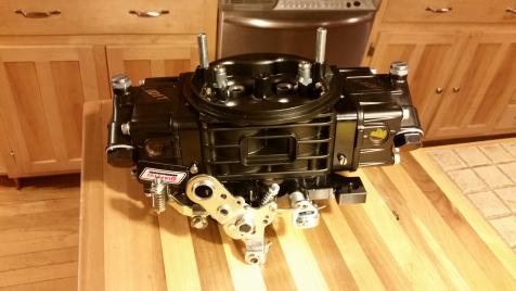

I hate spending a lot of money on anything until I'm confident that it's gonna work so the last 2 summers I've been experimenting with carberation buying them off Ebay then re-selling them to fund the next. First one was an 870 Avenger followed by a Demon 850 Mech Sec, both worked well and served their purpose leading me to my conclusion. Thanks to the guys here at FBBO I got in touch with Don at 4 seconds flat and got a Q Series 750 mech sec Quick Fuel headed my way already custom tuned for my setup and at a really good price. Showed up Friday and I was out cruising for a good 4 hours today with zero issues, the tuning was as near perfect as I could hope for out of the box. The off idle stumble that I had learned to work around was gone, 6th to 3rd gear full throttle downshifts are clean and crisp and it performs flawlessly no matter what you throw at it........ sometimes it pays to spend some doe. I'd recommend Don's service to anybody looking for a good carb, love it! Oh yeah, custom tuned, engine tested, black diamond coating, AN fittings installed and delivered to my door and still $87.00 cheaper than buying a stock QF from Summit... can't beat that!
Who is this Don fella?
Don at FBO (4 seconds flat), for some reason I can never find his site if I Google FBO but 4 seconds flat pulls it up everytime. They specialize in ignition and carb tuning, very helpful and knowledgeable.

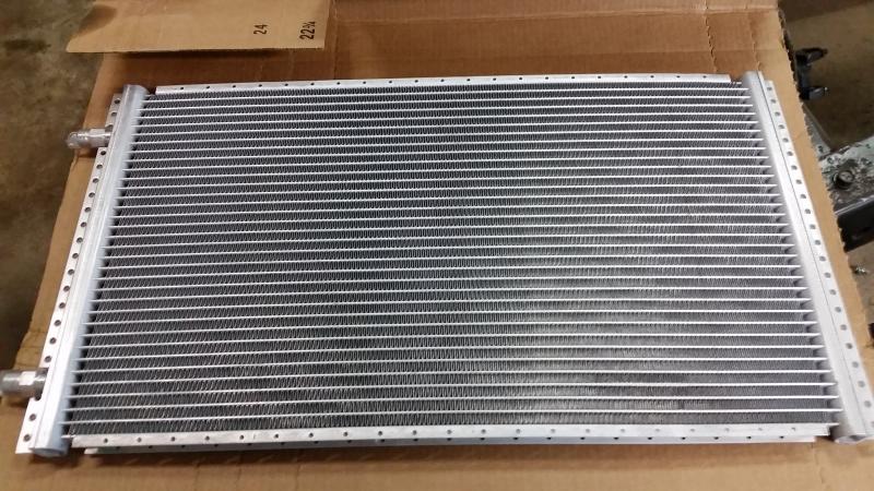

With all the money to be spent I spent wisely, went shopping at Summits scratch and dent sale and scored this $250 condensor for a whopping $75.00!

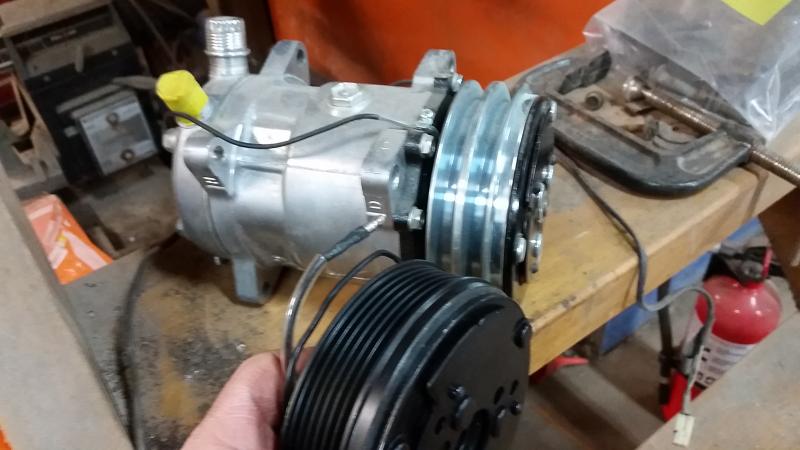

Since I already bought the saden pump when I was planning on running v belts I needed a serpentine setup.... $129.00 setup bought for $50.00 at the sale!

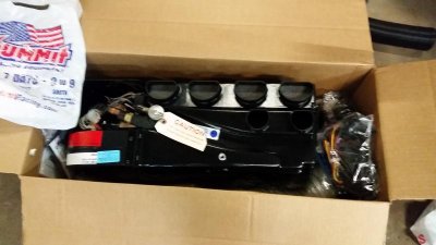

Picked up the Vintage Air Gen II Super Cooler.... full price :(

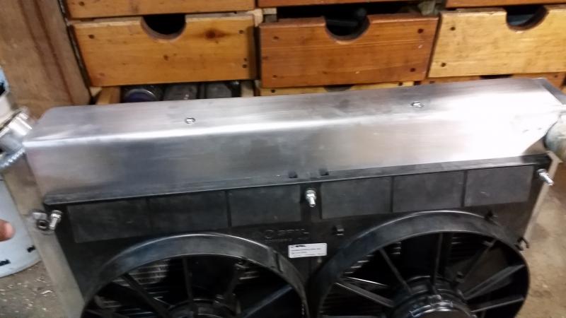

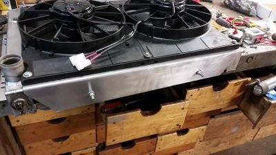

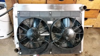

For fans Goon put me on the right path with a dual 11 Spal. This is a $350 setup scored brand new off Ebay for $200. Already made all the brackets out of stainless and is ready to rock.

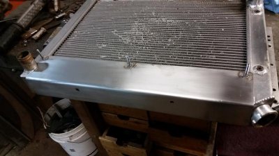

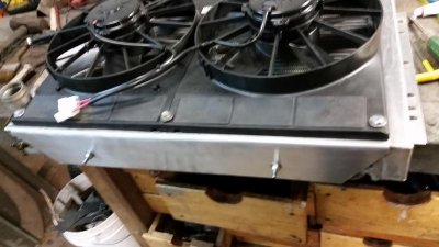

Here's how I went about attaching the fans. Stainless shrouds were bent to adapt the 16" tall fan to the 18 tall radiator. My brake did not like bending this stuff at all.

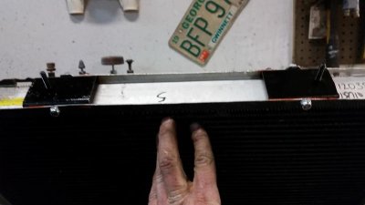

This was the best thing I could come up with for attaching to the bottom of the radiator, they don't give you much!

Those were definitely some good scored and the rad shroud and trim edges look great. Hopefully the fans play nice clearance wise with the serpentine system and you're damn near there

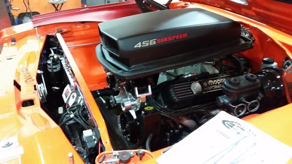

Figured I'd update the ancient thread with this years upgrades, also want to get this kit out there for as many to see as possible because it's one sweeeeet setup. This year I finally installed heat and A/C, I went with Vintage Air using their GenII Super Cooler. I know little about A/C but had zero issues installing it (not a kit but all custom), very pleased with the results. Only big issue to really take into consideration is the duct routing, the wiper arms are right there making routing something to put some thought into.

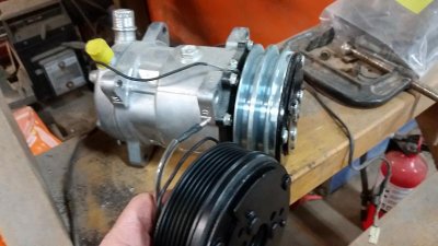

The switch to A/C meant it was time to deal with the belt setup, I decided to go with SD Concepts kit for a few reasons.
#1 True single belt with tensioner design.
#2 Tucks everything in neatly and mounts the A/C where it should be.
#3 Uses off the shelf readily available components.
#4 Doesn't look all crazy like some of the other expensive bling, bling kits.
#5 Cost, $650 for the kit.
The power steering pump, alt, crankshaft pulley and water pump pulley can be sourced from the salvage yard and you'll need to buy a water pump with an anti cavitation plate, the belt, tensioner and A/C pump from your local parts supplier. The reverse rotation water pump also means you'll have to deal with the cooling fan if your running a mechanical fan as well.
Put some miles on it already with zero issues.
