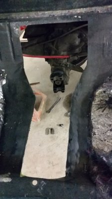

After some head scratching I decided it was easier to remove the whole area snubber plate and all to get my clearance so out it came.

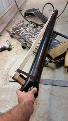

Next was figuring out how much to move it so I measured the distance from the axle to the bumpers and added some for good measure and mocked it up on the shaft (as long as it doesn't touch the stick it's all good).

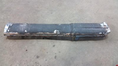

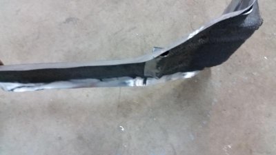

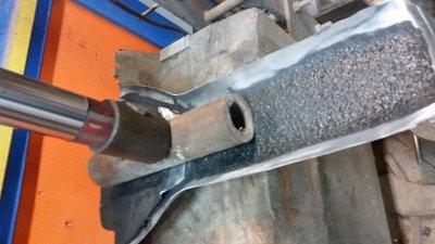

The bend in the reinforcement plate made it where the floor would have to be raised enough to interfere with the rear seat so I put it in the press and smashed it flat. With that done it only needed moved up 3/4" so I trimmed it off and test fitted it.

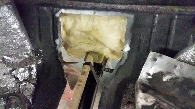

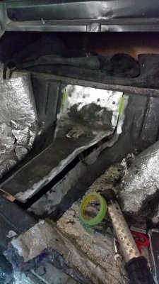

I didn't get a pic but I sliced the tunnel about 16" forward of rear set area and think it's good to go, everything should easily clear now.
Very happy with the results, I did a good enough job marking out the cuts that I can but weld the rear wall in with no filler metal at all and will trace the wedge shapes once the panel is tacked. Once this is welded and ground smooth only a true Mopar nut will know the difference.:headbang:

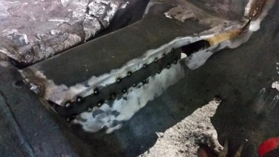

Extension welded on on ready for trimming and welding.

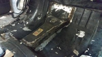

Seat area done accept grinding. Yes those are mouse traps, now that I have a hole in the floor I've got mice! I sealed it up and left several traps, death count is up to 3.

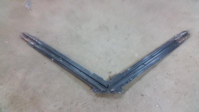

Got all of the damage from removal welded up on the bracing.
