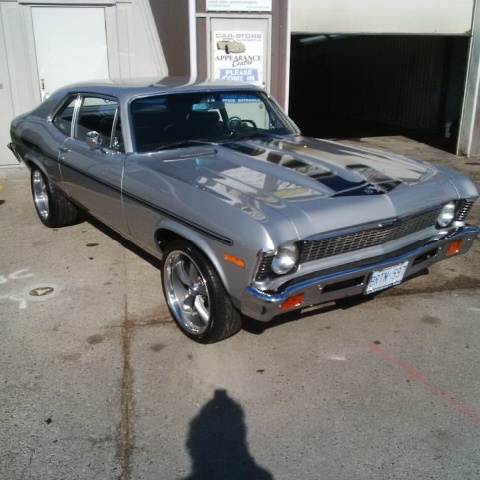

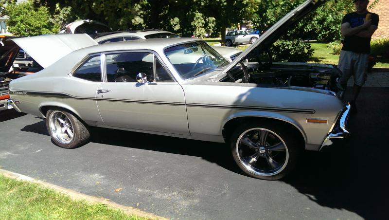

You could probably get away with removing the Plymouth decals if you get the car Wet Sanded after. It'll pretty much bring the paint back to it's original lustre if the paint is in good shape it would be worthwhile to either do yourself or have done. The best guy around here that does it would charge about $800 to do the whole car if that gives you a ballpark.
Sorry it's GM but here's my Buddy's Nova as a before and after wet sand just to give you an idea. This way you're not into removing the factory paint
View attachment 229254View attachment 229255
I would not wet sand and buff the original metallic enamel paint. The metal flake will flaten out during the sanding process, and you will lose that metallic sparkle. Base/clear....not an issue with metallics because the clear is protecting the metal flake. Solid color enamel car...not an issue either. Enamel metallic....a no no.
