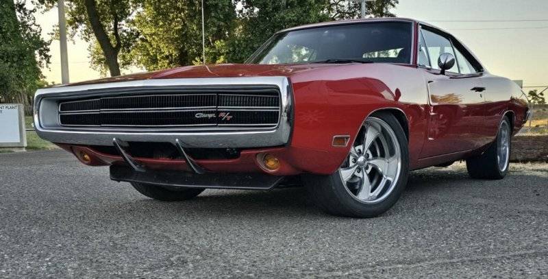

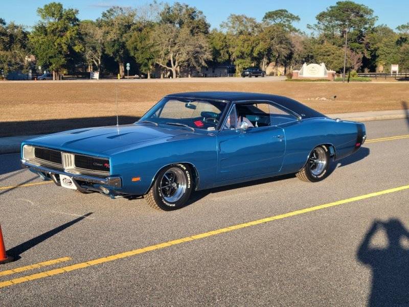

So, the charger had been lowered 3 inches when I bought it. (See before picture)
Took out the lowering blocks in the rear and cranked on the adjusters in the front.
Now THAT'S what a charger is supposed to look like!
(don't worry about the blue door protectors, they come off)
Yeah, the top pic is too low but the bottom pic is a hair too high. Does it have sway bars front and rear and did raising it change the handling?

low wasn't bad, agree looks better up. I would run front down an inch and or rear up an inch. J my HO and it's your car and what you like is all that matters!

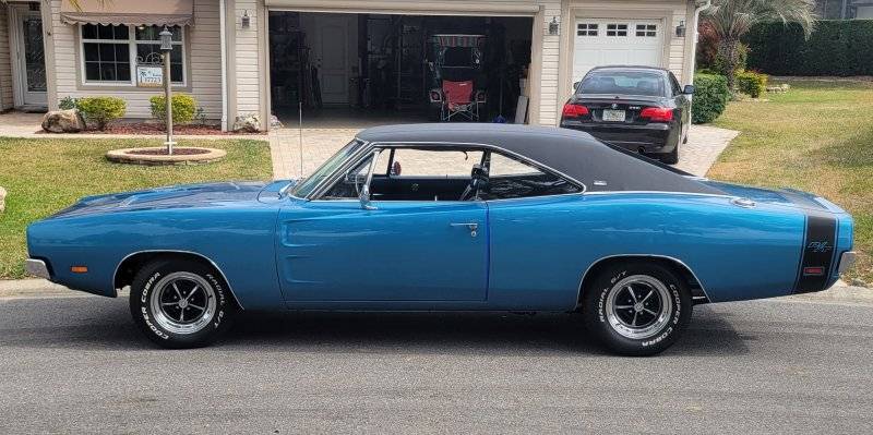

The car does look better at the current ride height....a comment I didn't expect to make given my usual preferences....
