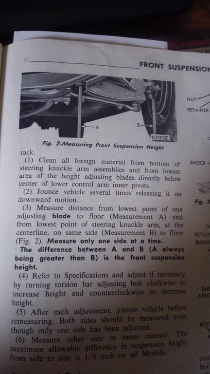

Let me ask a question. Do you know what the ride height is right now ? (And I'm not referring to the bogus wheel-well measurement). Did your wheel alignment guy know what your ride height is ? Did he even know he's supposed to check ride height ?

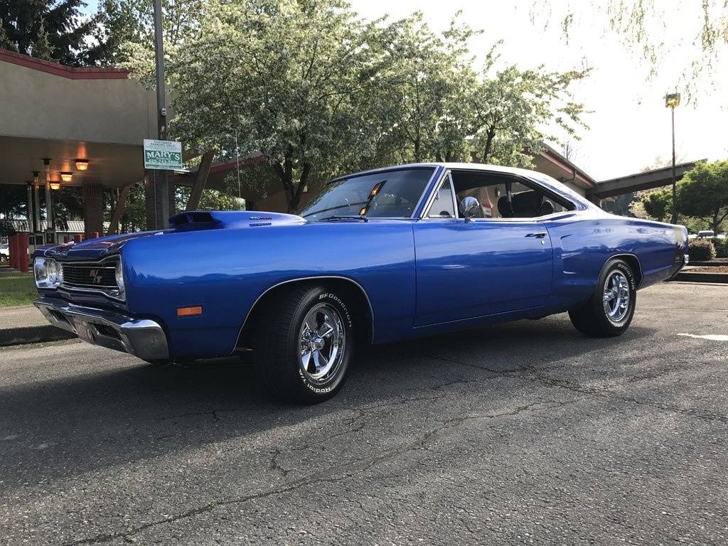

I went from stock torsion bars to 1.03" PST bars so I'm thinking the stiffer bars are holding it heigher than the stockers.
It doesn't need to drop much. The pic is a little hard to tell but the fender is just above the top of the wheel.

This is the proper procedure to measure your ride height. I would set the vehicle to the proper ride height and then adjust from there. So you take the 2 points and subtract the difference should be 1& 5/8" plus or minus 1/8"
