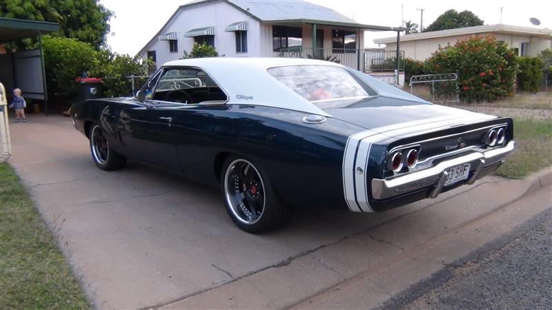

heres mine 18 x 8 front 19 x 10 rear, 68 charegr has similiar wheel wells
