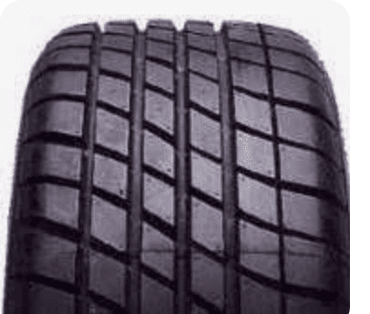

Hoosier makes sports car dot radials that would suit, but they aren't exactly inexpensive. They have an autocross compound, and a road course compound. 205 50zr, and 225 45zr in 15". W speed rating, 168 mph.
Both over $300 ea.
Betting both are under 25" tall.
Tall 15s and handling are kinda mutually exclusive.
