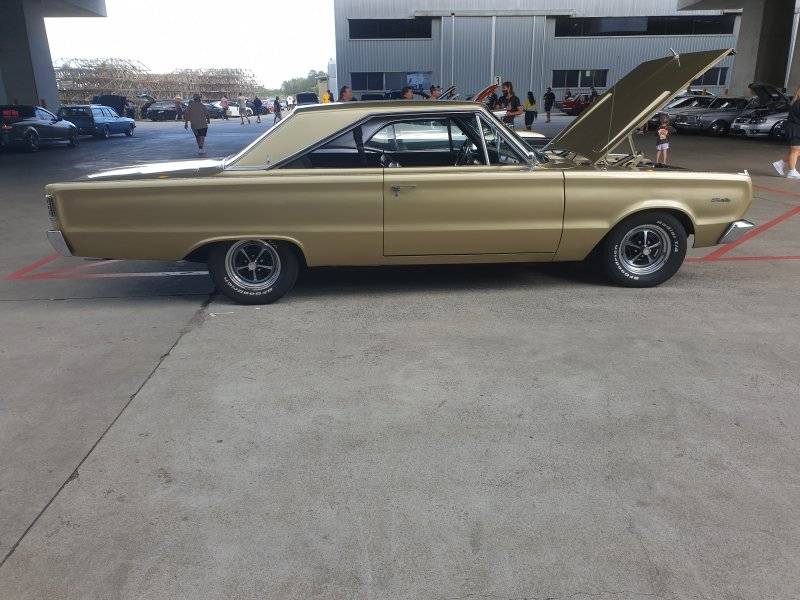

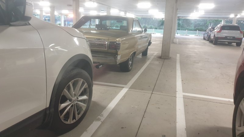

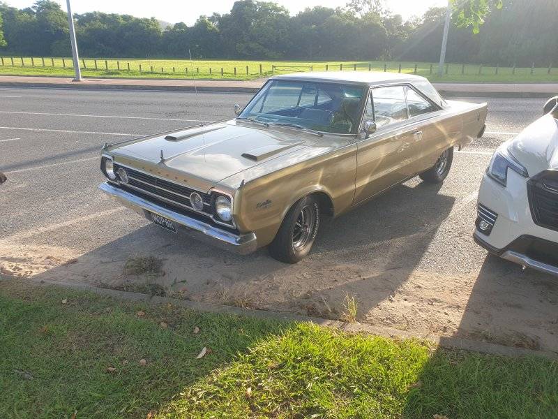

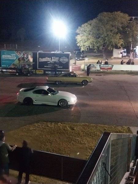

For sure I built my car to be a "go anywhere" type of deal.
To the beach
To the city
To the shops
To the track
To the car shows
With a 3.23 rear it cruises ok and will still run 100 mph in the quarter mile.
It's got just the right amount of power for the chassis, and gets decent gas consumption too.
I'm like most people and get excited about 600 hp Hemi cars that run super fast, but they would have compromises I'm not willing to make. I still admire those cars and love reading about them or watching them, but I'm happy owning a lesser version.
Your car is a pretty good all rounder too, maybe some electrically adjustable shocks are available to be able to raise it over speed humps?
Other than that it sounds like you're just a camshaft away from automotive bliss.

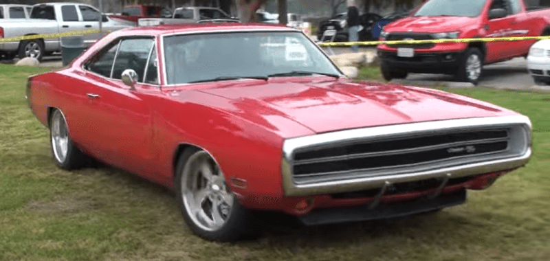

I know a guy, he used to live in this.....
....He was fearless. He was the type to jump headfirst into unknown situations and then just find a way to get through them.
On his first trip to and from Van Nuys with his "restored" car, he had several breakdowns.
The crankshaft pulley FELL OFF while on the freeway. He had some weird arrangement where pulley alignment was an issue so he welded three spacers on the back side of the pulley and then only used THREE bolts to hold that pulley on.
The power steering pressure hose moved and touched a header tube, burning a hole through it.
The engine vibrated so much, it rattled stuff loose including the shifter linkage.
He lived 3 hours north of me, Van Nuys is south for both of us. When he got to my house, he had 2 hours of wrench time fixing various things but it only got worse.
He had 4.56 gears in the Dana, an axle that was absolute overkill for a stroked 340. To make it "streetable", he added a Gear Vendors overdrive which resulted in a 3.55 final drive. Not terrible but it is when the GV barfed and left him to drive almost 580 miles home with 4.56 gears! He bought the GV used and never added oil to it!

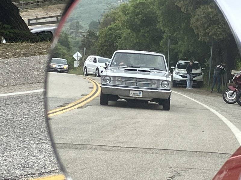

Same guy, same car.....another trip to Van Nuys, he was on the Malibu Cruise and the threaded stud that retains the air cleaner rattled loose and fell down the carburetor and into cylinder #6, splitting the cylinder. This required a sleeve to fix. He also found that the engine was WAY out of balance, something that he was told by several car guys but he refused to believe it until a shop employee convinced him of it. He had an 18 hour stress induced experience finding a U-Haul truck and trailer, loading, driving then unloading when he finally got home.

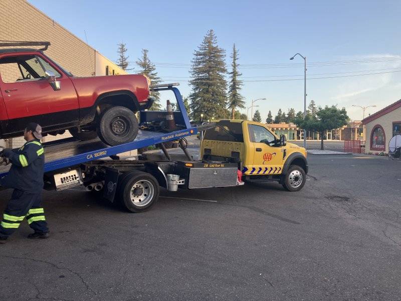

One of the fringe benefits of being a truck driver was the guy who did my maintenance owned a towing company, and gave me discounts. But I never had to use his services on a GTX.
I've only had to use my AAA towing service once....
This was just to make it easier. I could have gone home and got my other truck and load it onto the trailer.
This was another instance where I developed a "No-spark" issue.
What the heck, man!

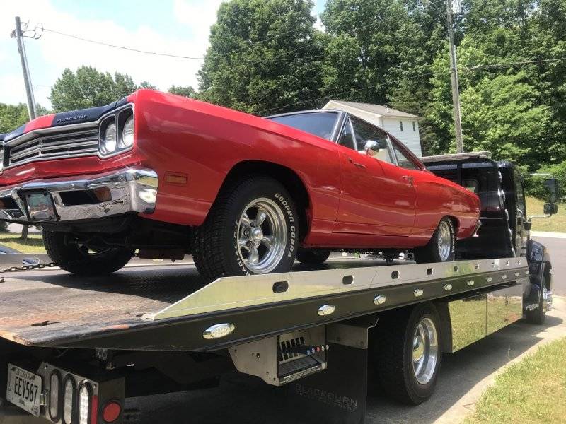

Had to have the Road Runner towed to the house after a lifter failure which turned out to be a cam lobe worn. Still ran but didn't want to hurt it any further. Which by the way was my fault had a Caddy CTSV right behind me and he opened his exhaust and ripped up behind me. So I pegged it and let her rip.. After that rip I heard a distinct lifter tap. Anyhow got it home and swapped the cam and lifters.

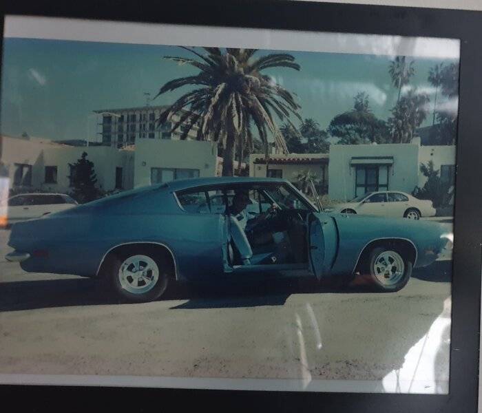

I think the "suitability" of these cars on long trips is also dictated by the age and condition of the owner.
In '97 I drove this Barracuda from San Diego to Vegas, Vegas to Sacramento, then on to San Francisco and finally down to LA. Maybe 1,300 miles? Admittedly it had 2.76 gears but the the only issue I had was a missing fresh air door on the driver's side freezing my nuts off until I blocked it. It was January, freezing cold at times and snow through the Sierra Nevada mountains, but that was my only complaint. Why? Because I was 23.
Now I'd probably be complaining "oh my back's sore, my hip's killing me" etc.
Sounds like a great drive!! I still enjoy taking them out but gotta admit, it hurts more than it use to....
