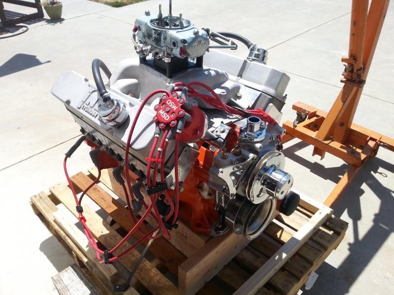

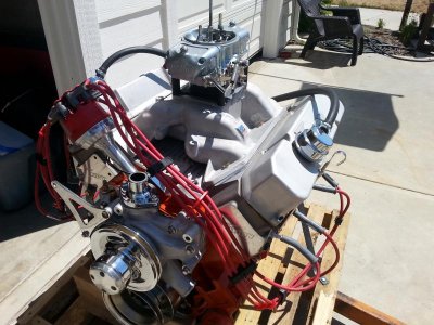

crate 1.jpgcrate 2.jpgReading this thread about your block/motor prep is better than ****...lol.
I see you're running a fairly short con rod. Curious what went into that approach. My first low deck "stroker" with stock 440 crank & stock low deck rods. It ran good. But just curious why not a longer rod?
Oh, I see that's the std kit size that keeps the pin below the oil groove. It should work the intake manifold really good, piston moving away from TDC really quick.
yep, nothing trick. just seeing what i can do with mainly off the shelf parts.
well I'm committed now... only reason i ever started this project is i didn't want to keep worrying about the LY rods in the 440. in hind sight i should have just tore it down and put some good rods in it and tossed it back in. My Hemi is getting tired now, these resources could have been better used if allocated to that thing. Good thing is i have a challenger i hope to restore some day, figure the 440 would be a perfect fit in that, it'll just be a cruiser.
