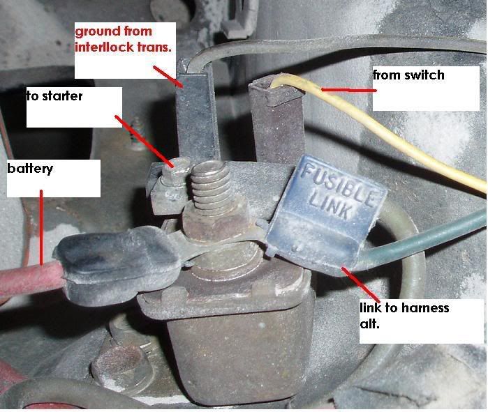

Check the condition of the yellow ignition wire which runs from the bulkhead junction to the starter relay. Any corrosion or fraying could exhibit these symptoms.

Well you may be in luck then. Disconnect one side of the battery. Take a wire brush or some fine sandpaper and clean the male connector where the yellow wire goes. Spay some electrical cleaner into the female connector of the yellow wire. Re-connect. Re-connect battery. You "may" have it fixed.
If you can work an electric meter, if it ever does it again, check for 12V at that yellow wire while someone turns the key to "start". If you have 12V & it won't start, then I'd suspect the starter relay itself (easy to change). If there's not 12V, then I'd suspect the ignition switch itself or the neutral safety switch (maybe take it to a shop).

I'm a firm believer in the 'ol jiggle test...(no jokes please!) It's a good way to find poor connections, the best thing is to eliminate possible points of failure start with the battery and work outward from there...use a voltage tester and a helper if you have one. If wiggling the yellow wire seems to work it could be the terminal end on the wire itself or the relay, or the common spot for trouble the firewall bulkhead connection..I might take a screwdriver, and on the relay, jump the battery terminal to the starter terminal as well, to eliminate the battery/starter/solenoid and their wiring as a cause...
