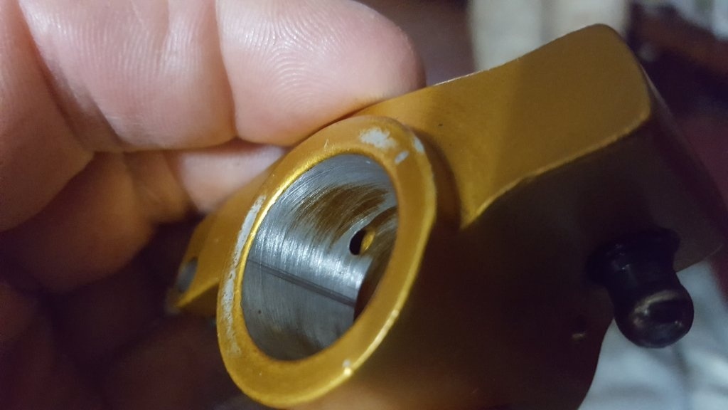

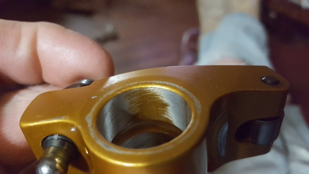

the rollerized harland sharp set-up is matched parts. they use a special shaft to hold up to the extra pressure that needle bearings run at, and 7/16" adjuster screws; pretty sturdy for alum. a bushed or unbushed rocker distributes the load better, but i don't think they're necessarily made better or stronger. i think the rollers coming apart is more of a problem with the chinese stuff. if rollerized gives you heart burn then do the steel bushed comp cams. i know some engine guys like the PRW comp cams clones. keep in mind that the comp cams type stuff uses a ball & ball push rod and the adjuster has an oil feed groove that needs locate with the oil feed hole in the rocker.
