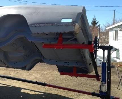

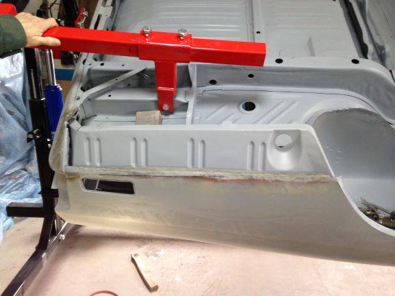

Where the rear springs attaches. The holes for the rear spring bushings go. Thanks Stanton for me knowing that one. I'm pretty sure you could do sort of the same with the front? But why not take the front one off? Since your going to the trouble of putting it on a rotisserie. And for the rear just pull the bumper and attach it there. I used both mounts for rear of my 70 Charger. They both have their own benefits. Depending on what you have to do. Where there is a welder there is a way.

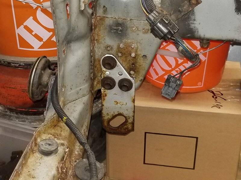

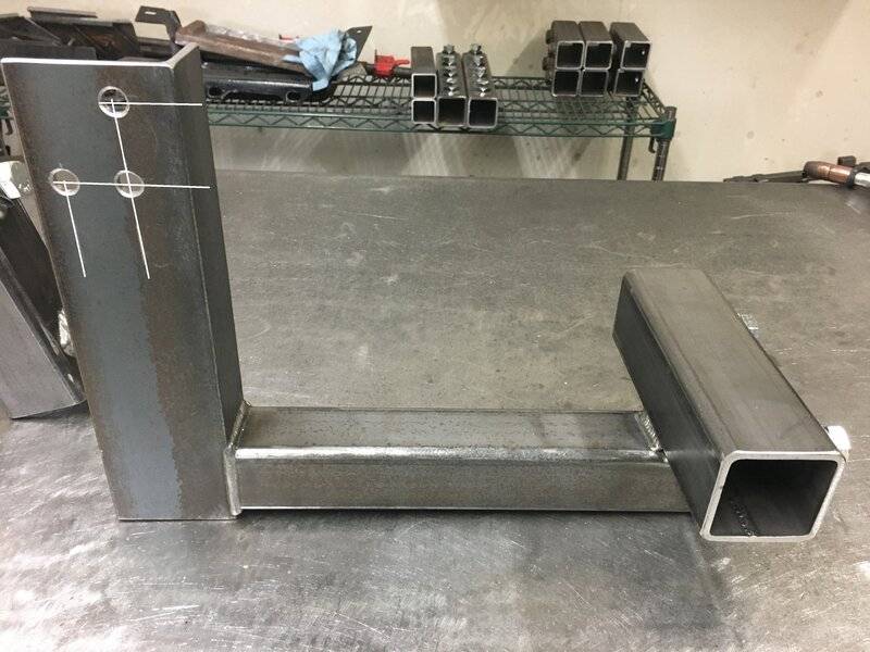

Yup, that's the way to do the rear. Here's a shot of a pair of front mounts for an Acura Integra. They obviously won't fit your b-body but hopefully you get the idea.

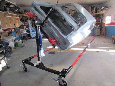

I see your rotisserie has two telescoping bars. I'm guessing it's more rugged and stable.
That's the idea! The rails are actually light gauge since they are not "structural", all they do is keep the whole thing square.

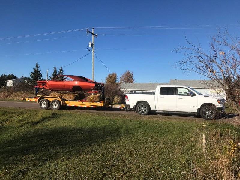

Real sturdy just the same. Took her home like this. About 30 miles. Never budged. Mind you I drove home at 20/40 miles per hour considering the road condition. And yes I stopped about 4 times on the way home to make sure nothing was moving.
