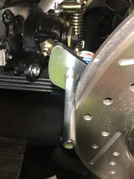

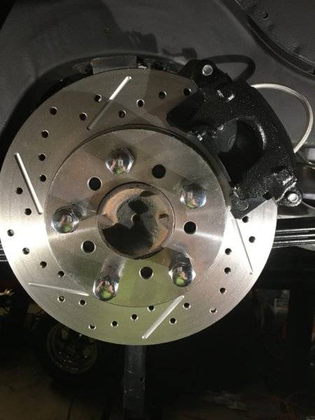

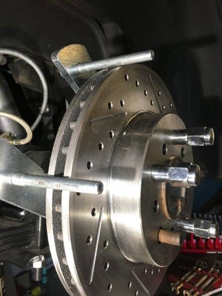

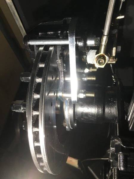

I purchased a disc brake kit for my 66 Charger.
Both of my rear rotors are rubbing on the caliper pins.
Car has a 8 3/4” rear end.
Pins and caliper brackets are straight and not bent.
Rotors are centered and sitting on axle hub like it should.
I’m thinking the rotors are too big.
AF26D3E6-1B48-486E-B98F-2F23E49373CD.jpeg 72D6F522-731A-4ABA-9C59-9AEAD160637E.jpeg BB8C51D7-285E-4B80-86D7-11E645D7AB5B.jpeg 97F5A576-9B4B-463B-8489-B6F63BA763B4.jpeg

The company I purchased the kit from got another call from someone else with same problem. Finally! Giving me credibility.
THE ROTORS ARE OUT OF SPEC!!!
I was told by salesmen for the company that he had to get two sets of rotors from China for me and the other person. They should be here next week.
I’ll let you know if they fit.
ps the company isn’t selling that rear kit until a new run of rotors come in from China come in.
