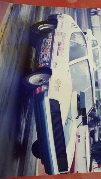

Doug, neither of my Cheetah valve bodies took more than 200-250+/- with 5 or 6 different 727's & a few different band, clutch material, lever, & front clutch spring combination. Griner brake VB same. My Cope valve bodies sure seem in that 100-200 at most. I don't think I have the power you do. But in my 9.3/147 Arrow, the 1-2 shift came pretty quick & it sure wasn't lagging 600 RPM. Just say'n.
in my 9.3/147 Arrow
Pix?

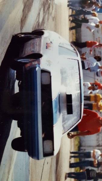

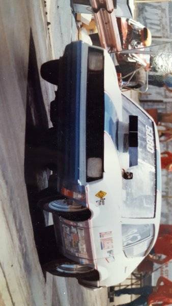

Here's a few. Sorry they are sideways.
