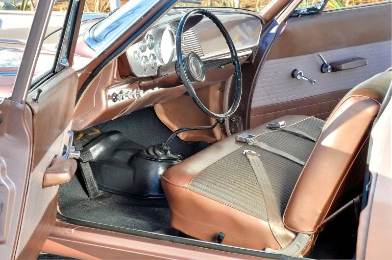

You could just do this
Mine doesn't have driprail molding. It didn't have anything on the floors, so I don't know. It's got carpet now.
