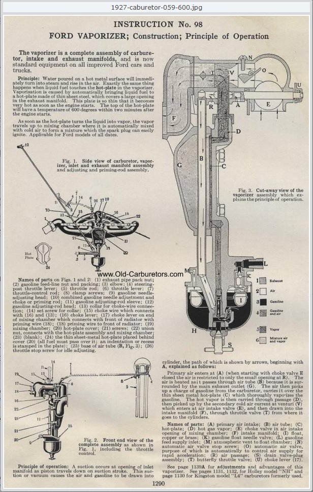

And they were thinking like this in the 1920s...
