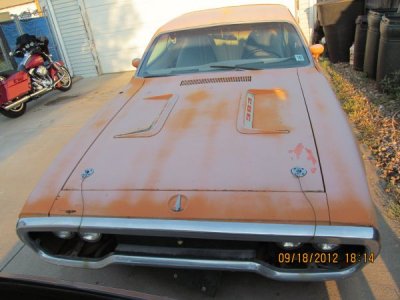

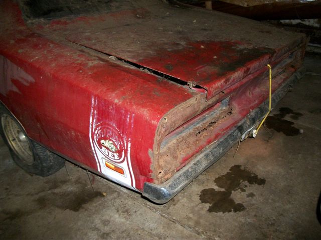

View attachment 85815View attachment 85816 Mopar project cars 013.jpgView attachment 85814LOL seems all I do is blocking... giving thought to 3 cars to pick one..... 69 Super Bee, 69 Charger, or 71 Roadrunner... There is also a 70 Cuda
You will probably want to start with a good cleaning then go after the straight surface rusted panels with some converter or etch primer. Filler primer with a catalyst will fill the rust pits then block like crazy. Then let it sit for a long time so it can shrink and see what shows up. Maybe apply another coat and sand more. The trick to NOT having rust come back is to seal it from the atmosphere. And if you do any panel welding you MUST seal it from BOTH SIDES of the weld.
As far as for which car? If all need similar work pick the one that has the highest collector value. Starting with the 70 Cuda and followed by the 69 Charger, then the Super Bee. I'd pass on the 71 RR unless it's something really special like a 440+6.

$4000 each. Buy several and I might deal some. RR was a 340/4spd, 69 Charger was a 383/4/spd, and the Bee was a 383/4spd. All have rust and all have salvage titles.
I would keep looking for a complete car. That not riddled with terminal cancer on 90% of the body.
You can get a lot of good restored drivers to restored cars right now for the price of what it would cost to do body work.
I'm still wanting this 71 Road Runner but not sure I can afford it....but I'm still thinking on it.

I could see spending maybe a grand if you were wanting to make a beater race car. No engine and trans really kills the value also. What else is missing from those cars? I would keep looking.
As others have said, the salvage title drops the value tremendously. If you are going to put a lot of money in a car and keep it forever, no problem. Usually though, we spend a fortune and then find something else that we'd rather have and in trying to sell your project find that most buyers won't consider a salvage title. The comment about being a bodyman was a good one. All those cars are going to be a massive amount of time and money to bring back if you're not in the trade. If you want something to drive sooner rather than much later, I would look further and in a drier climate. Better cars are out there for less money. Good luck on your search.
I watch some the resto shows on TV and sometimes they start off with cars like that but they normally have a team of body, mechanical and parts techs doing it. Not to mention a lot of money even though they whine about going over "budget". Usually on the ones that are badly rusted, they blast them with baking soda or something. Those just have too much wrong with them.
