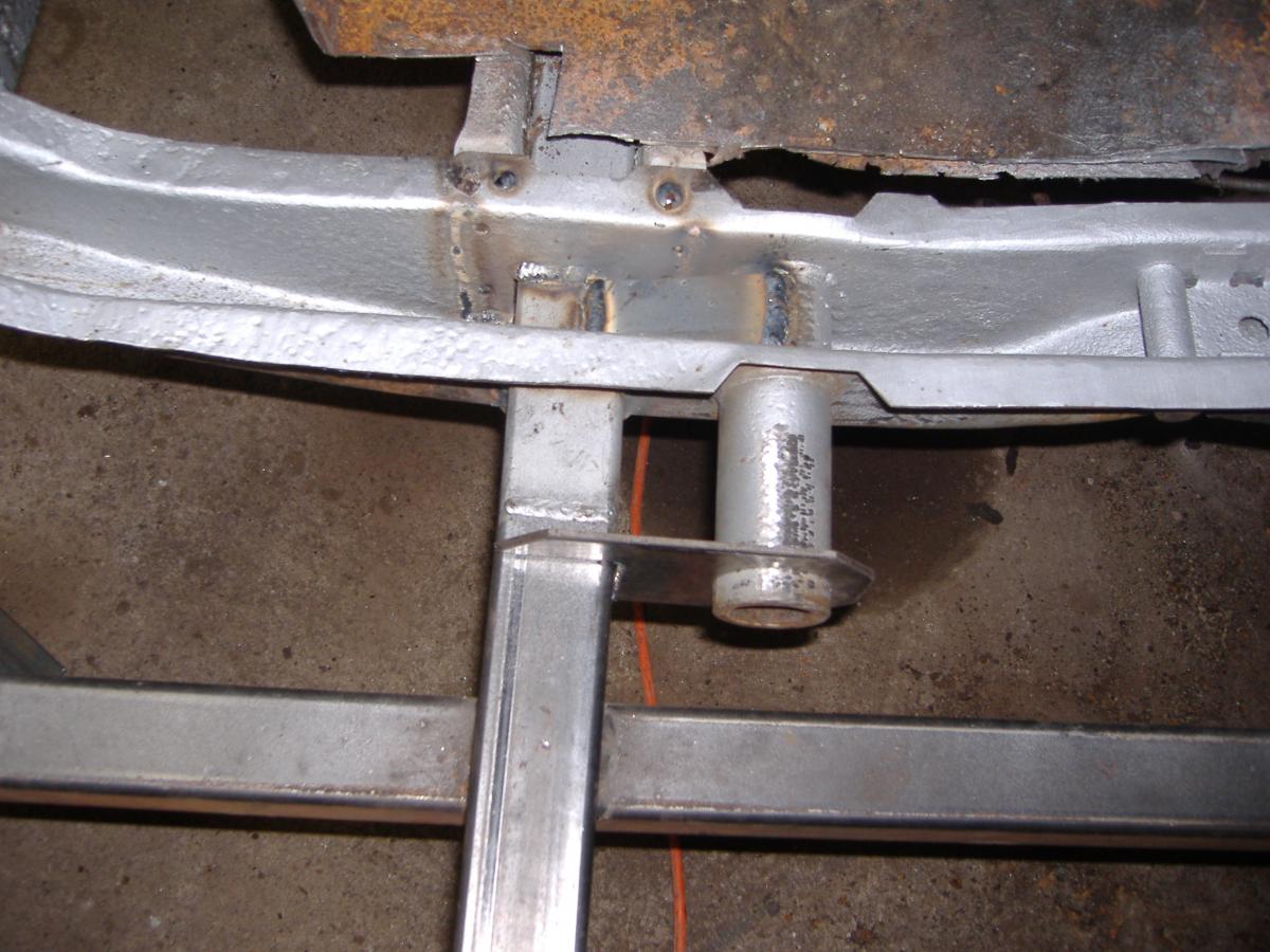

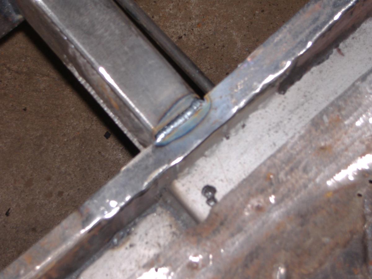

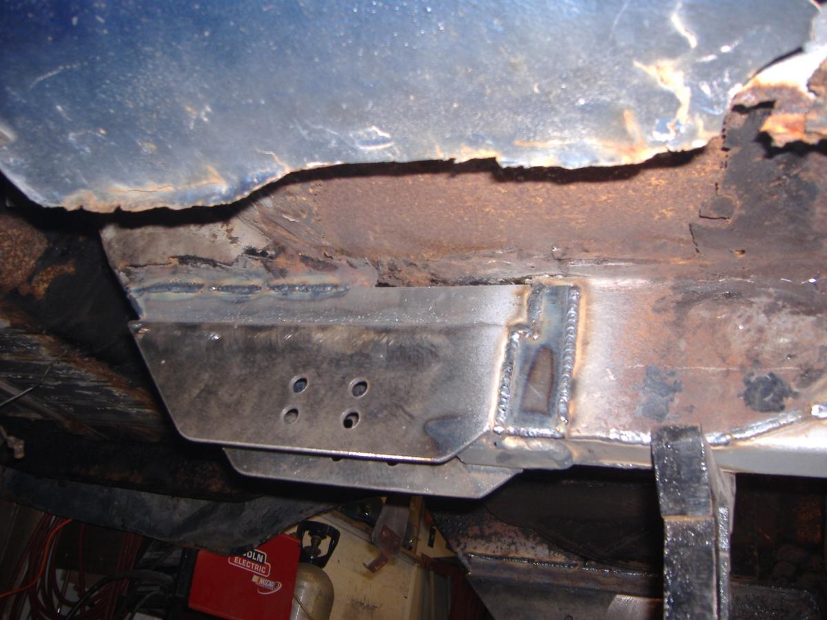

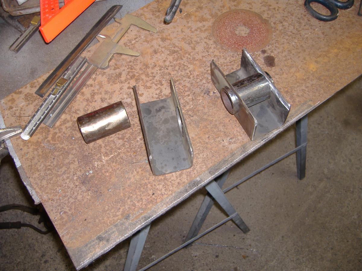

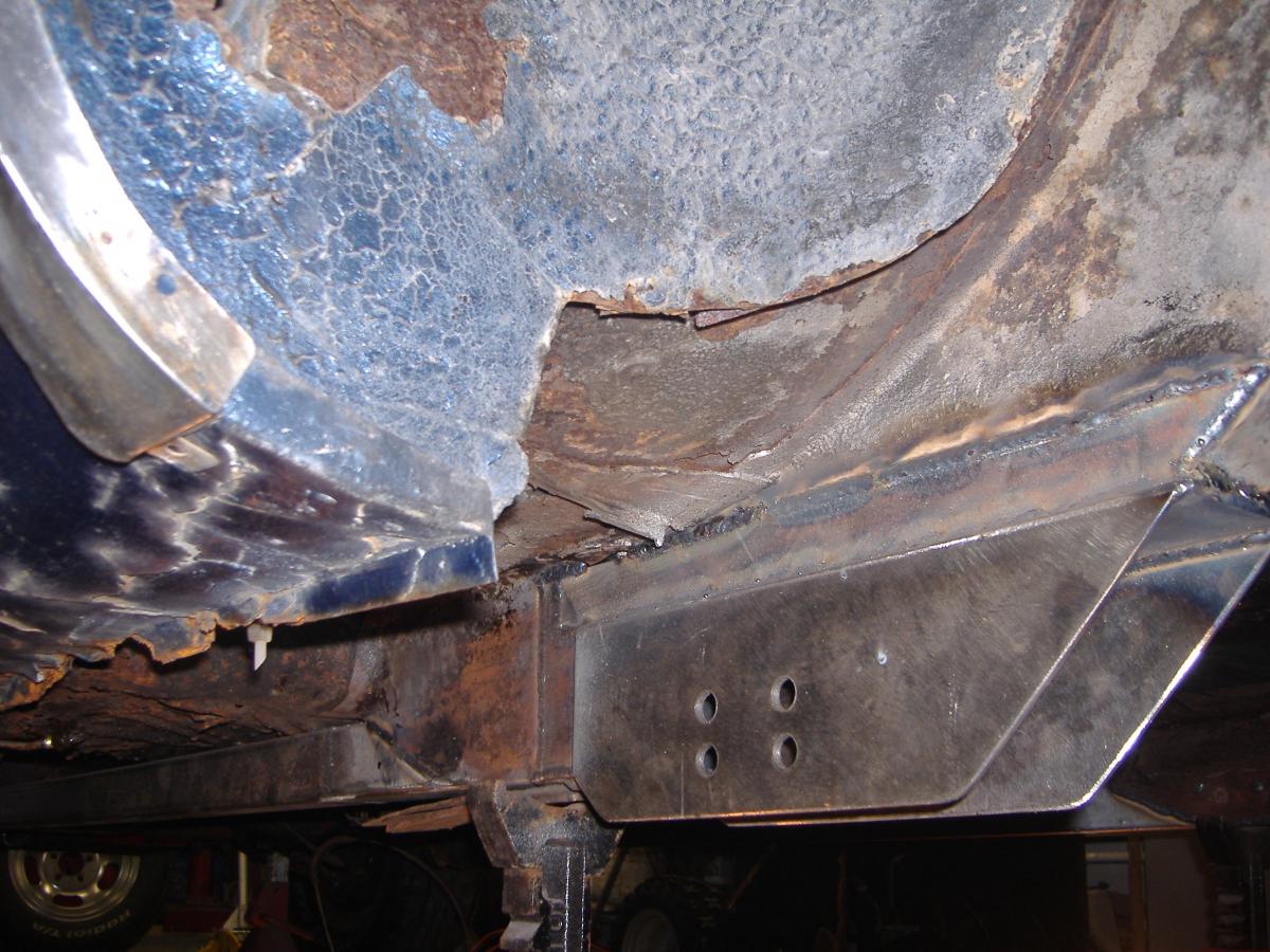

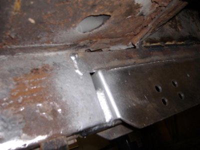

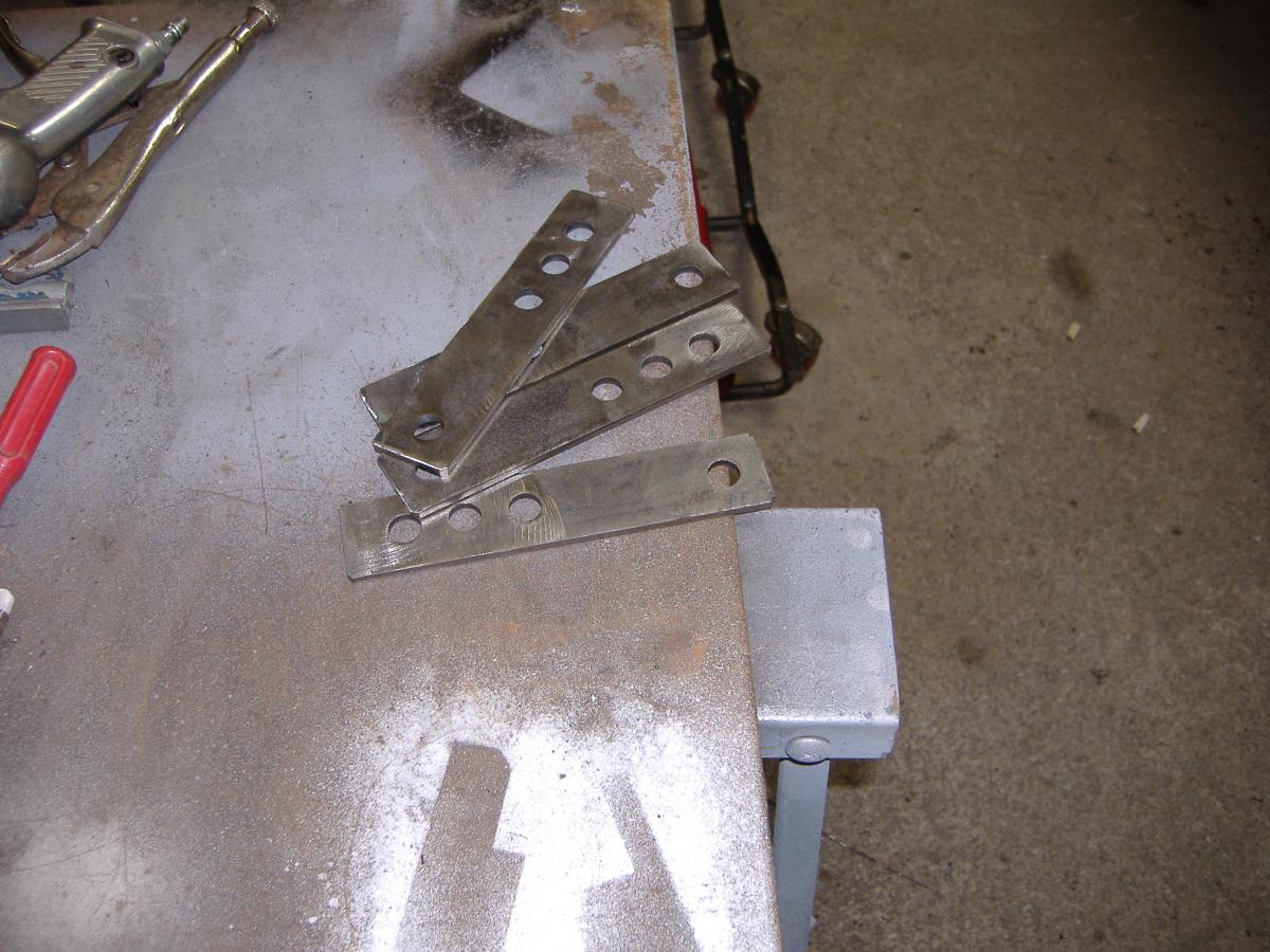

Finished off the spring box's by fully welding them to the connectors and the original rail sections, then I added plates to the joint to reinforce the area and to blend them in to the upper reinforcement plates.

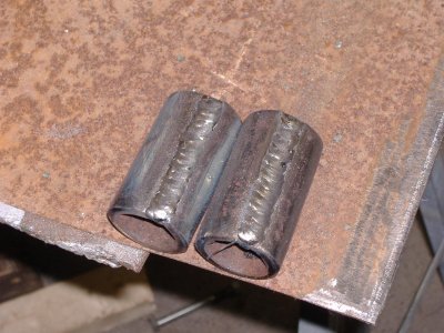

Cut the eyes off two old springs and made the rear shackle mounts. I put them thru some tube sections with the top cut off. That way I was able to just cut the bottom of the rail out instead of using a punch to cut round holes thru the rail.
I aligned the shackle tubes by using a tight fitting wooden dowel. Had to cut it in pieces to get it back out! LoL
Made some temporary shackles with adjustment holes till I decide exactly what length I want them to be.

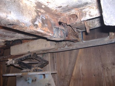

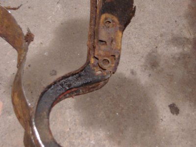

The shackle mounts that she was using were rotted out and they had been replacements already!
Not much holding them in so I think it will be an easy removal job.
Seems like maybe just 4 or 5 small bolts!!!
Could be some tacks too...not sure.

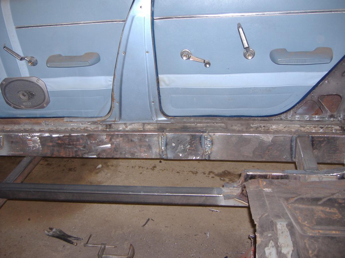

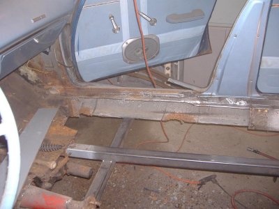

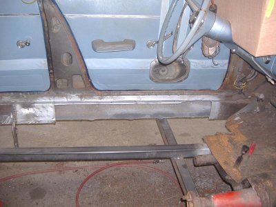

A few more pics...

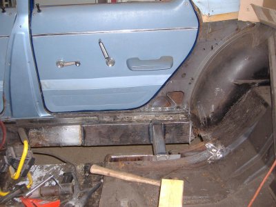

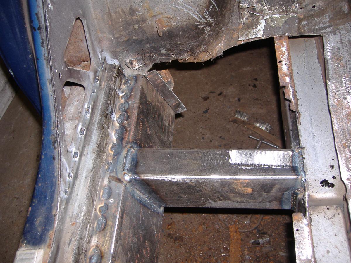

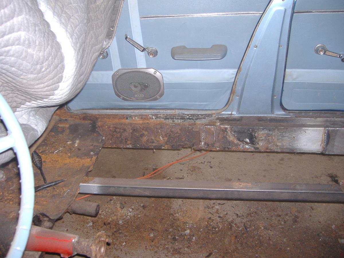

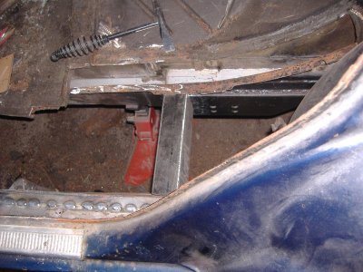

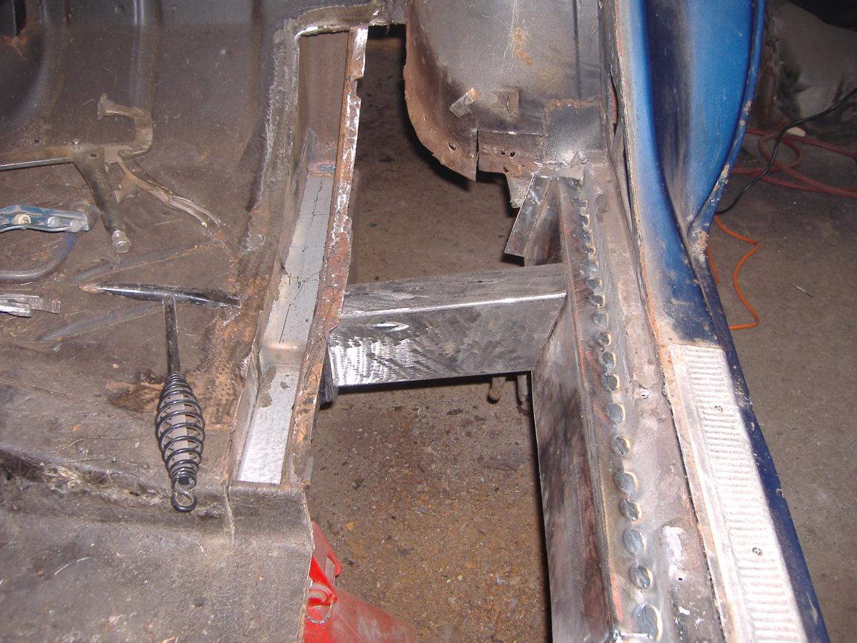

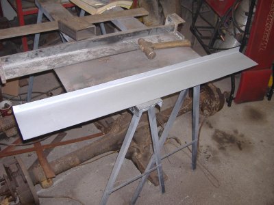

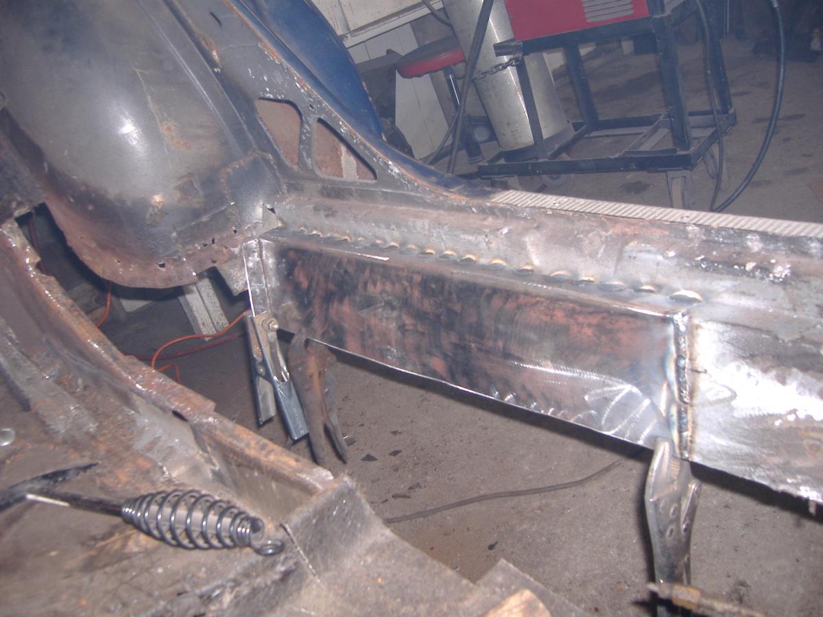

Repairing the rear section of the inner rockers and adding the 2x4x1/8 tube supports.
Getting her strength back!!! :D:D

The rest of the pics for the pass side...

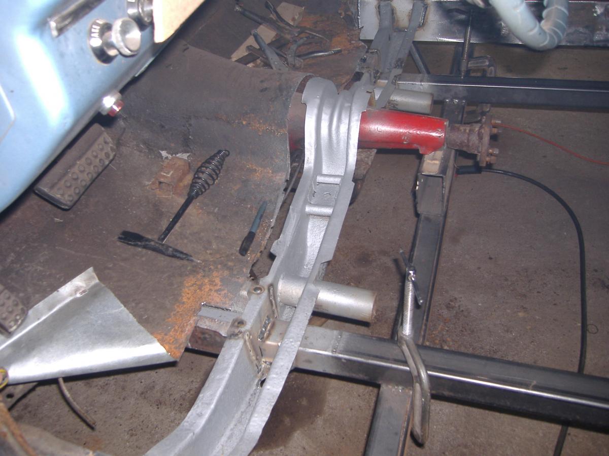

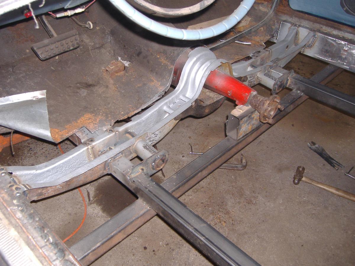

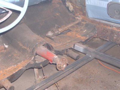

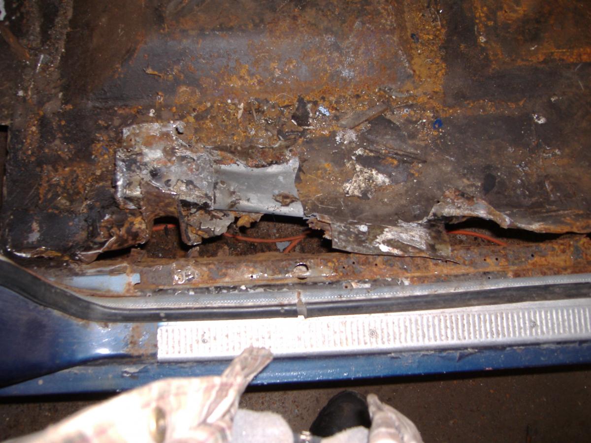

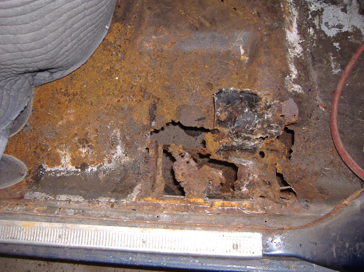

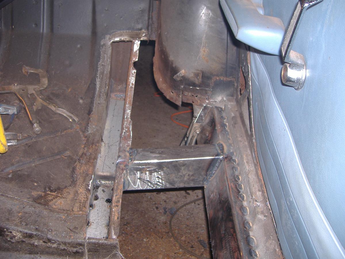

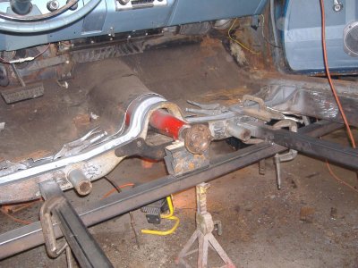

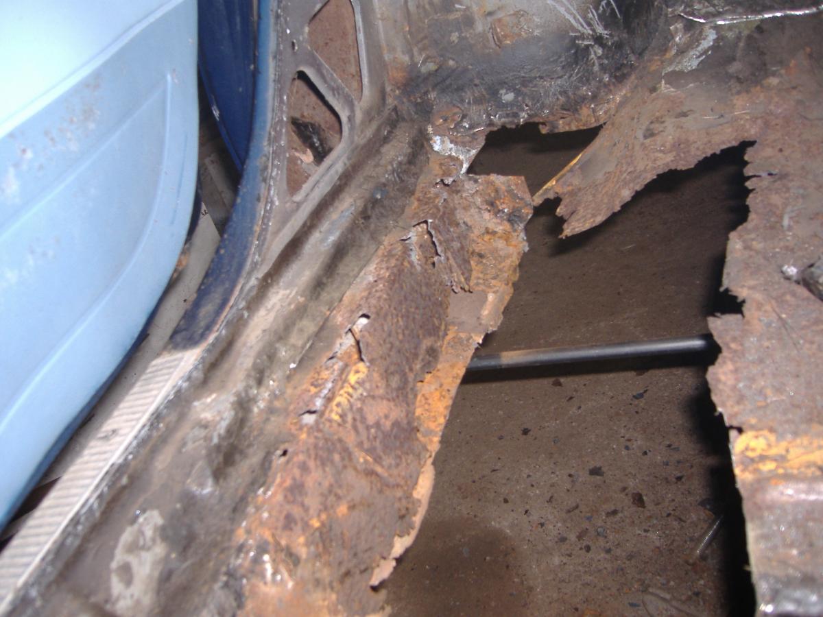

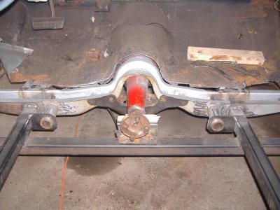

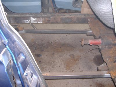

With the rear rails strengthened and the spring boxes complete it was time to start removing the floors, repairing the inner rockers and getting ready for the torsion bar crossmember.
The pics can do the talking!

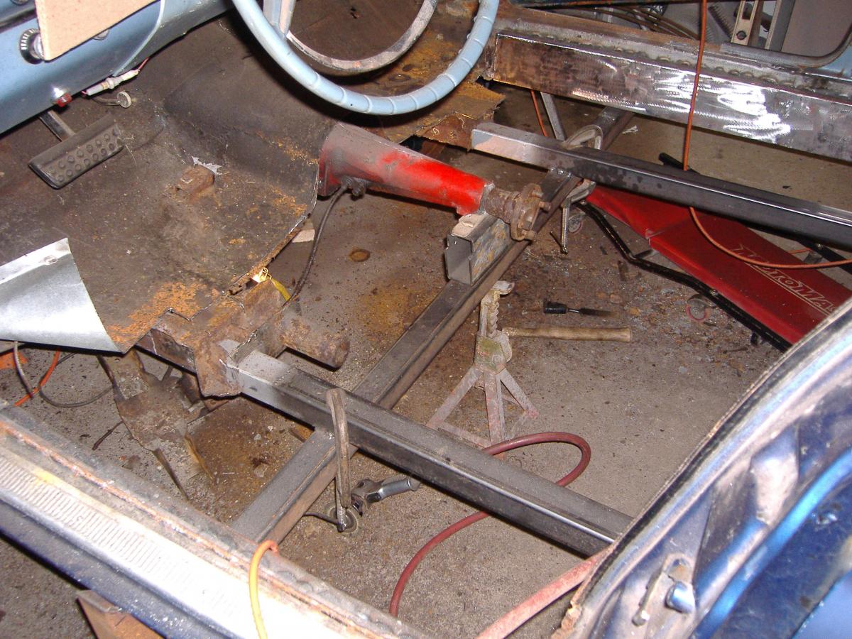

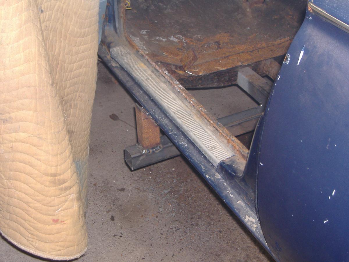

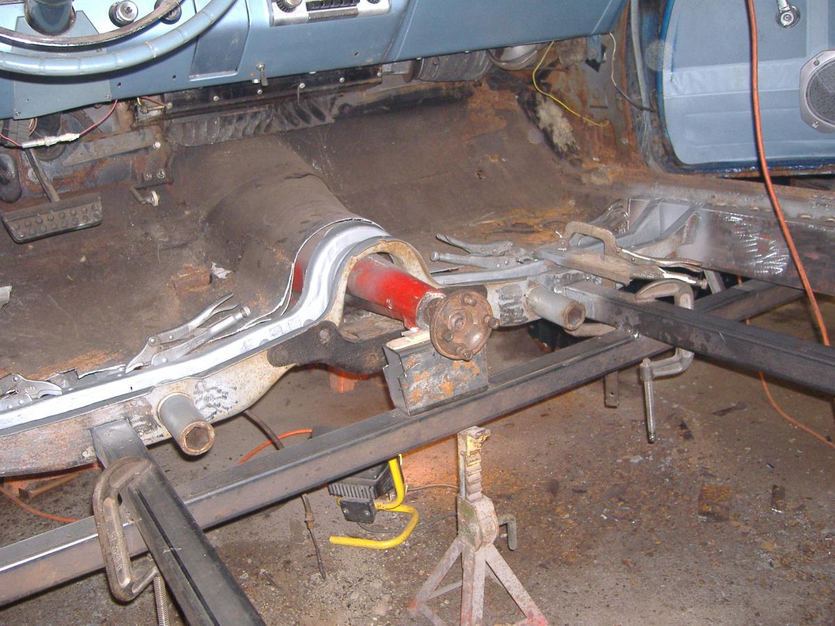

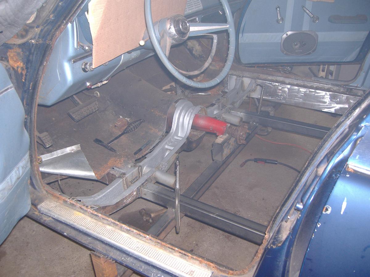

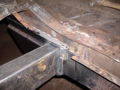

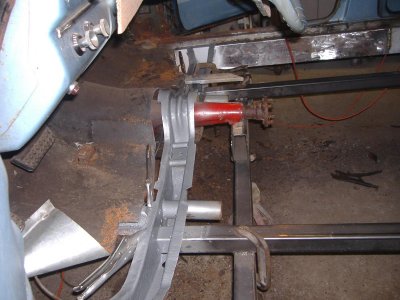

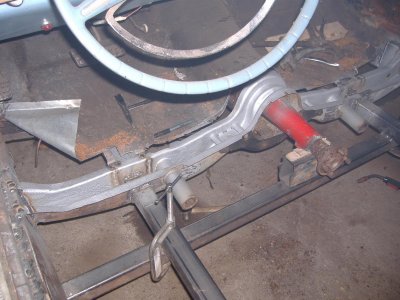

Put in a temporary crossmember and cut out the inner rocker sections.

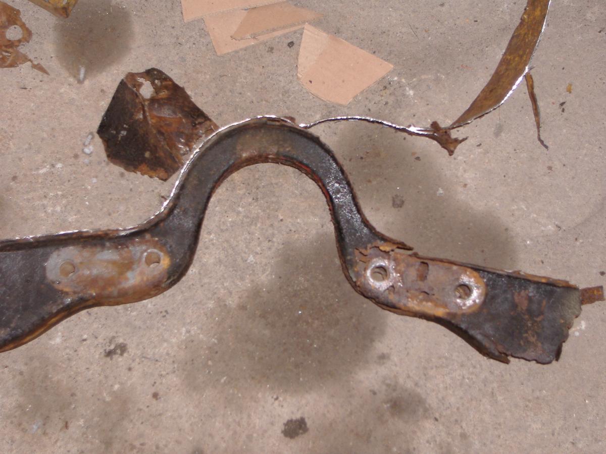

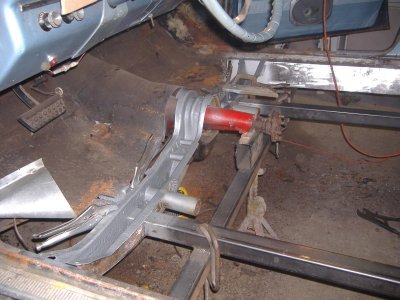

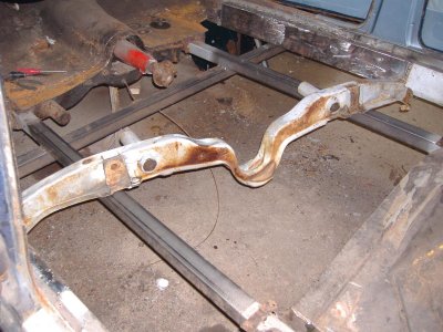

Cut out the old crossmember and fitted the replacement.
Really happy I was able to find one...that old one is a mess!

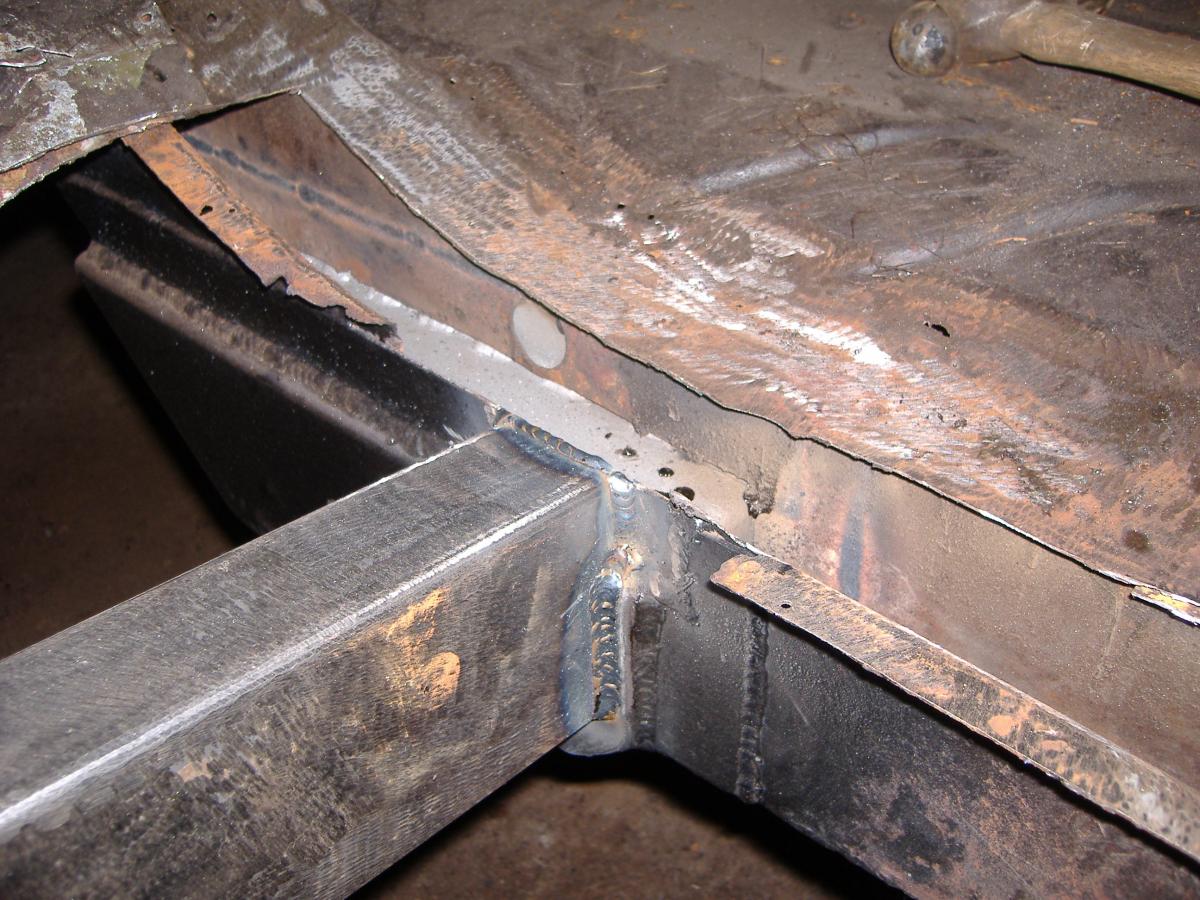

Got it all welded in place...

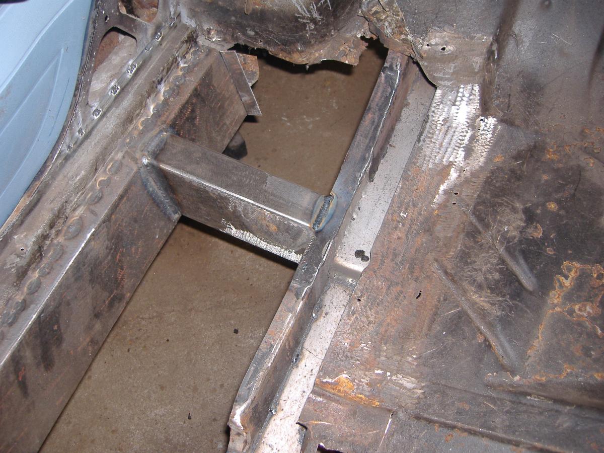

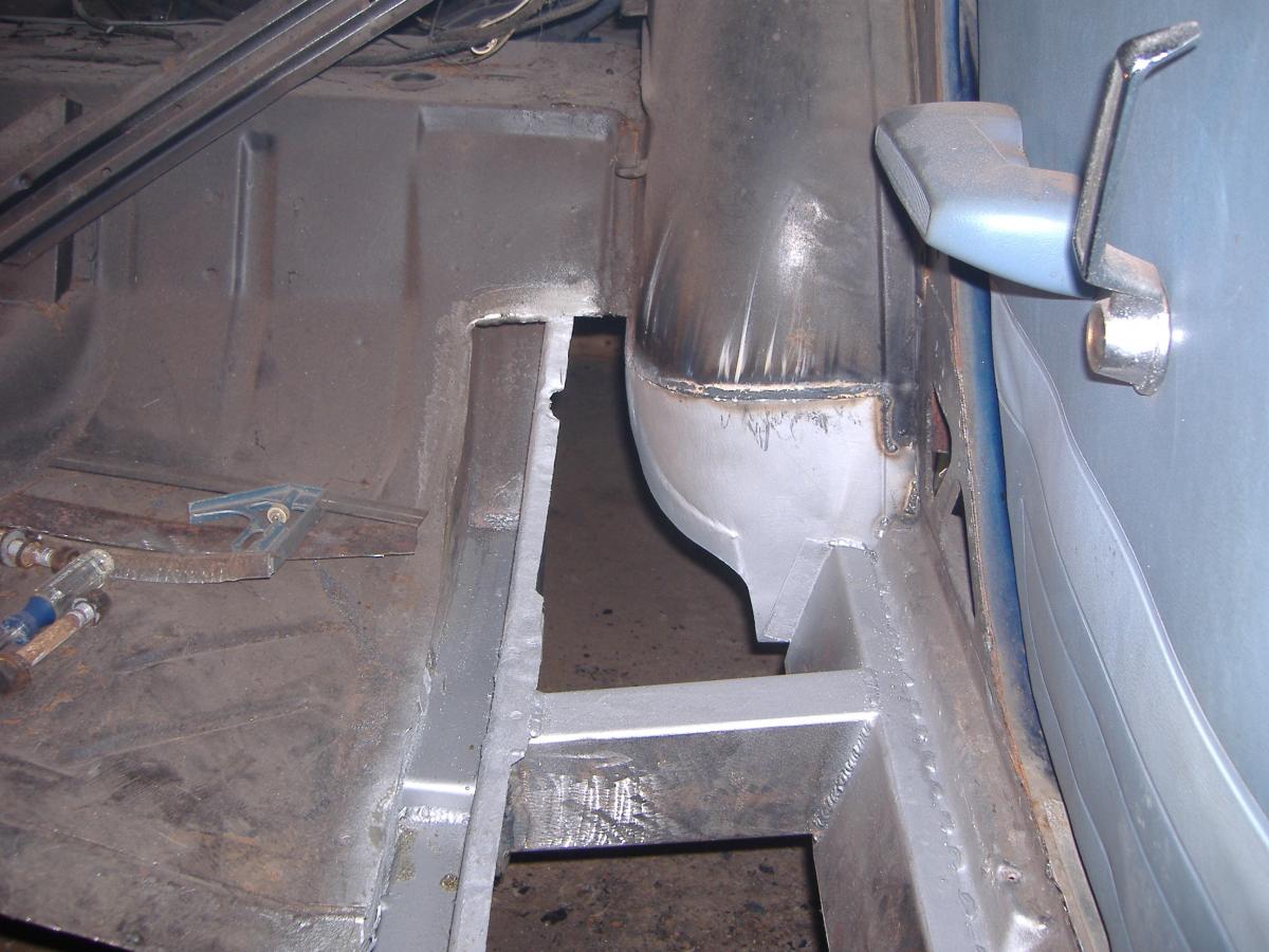

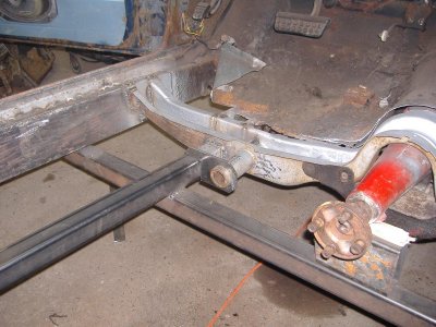

Reinforced the torsion bar sockets by welding tabs and braces directly to the connectors.
Also repaired the top edge of the right rear rail.

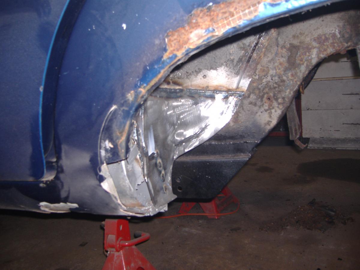

Put in the rocker pnl seat belt brackets and repaired the front of the left inner wheelwell.
